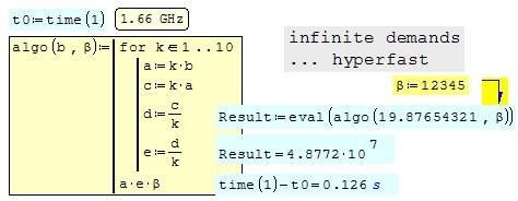

I am new here, and facing similar problems. I intend to replace MathCad to an alternative solution due to PTC's pricing and support policy. I was very happy to find SMATH, and I started to test it. For short calculations it's a good alternative, but it seems very-very slow when long iterations are needed. I made a short loop both in Mcad and Smath containing just a few multiplications, and calculating it 1000000 times took ~0.2s for Mcad14, ~1s for Mcad8, and 32s for SMATH. So now I am a bit upset...

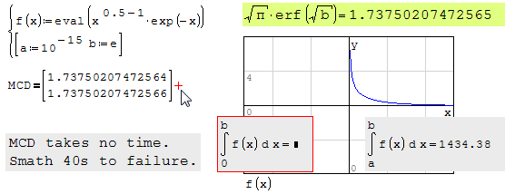

In some instances, Smath is slightly faster than Mathcad 11.
However, almost not observable.
In other instances, Smath is horribly slow.
1 min Julia in Mathcad takes over 2 hrs in Smath
Same observation Fourier CoC ... and more.
Please, attach your document for Smath Community to doctor.

speedtest.sm (4.53 KiB) downloaded 1312 time(s).
This is the file I made exclusively for speed check. There is no need to improve this calc by modifying it's structure, it is just for test purposes not a real task.
I started to use Mathcad in the last century (V6.0). I made several calculations for example to simulate transient temperature rise of electrical rotating machines. I know there are better tools but I am familiar with MathCad that's why I am looking for a similar sw.
Just for demonstration purposes, I've been able to increase the speed of this calc ~25% on my machine just by using vectorization rather than the for loop. It's still not near the performance you'd like, but just goes to show there are often things to be done to improve calculation speed. Vectorization isn't always possible in some algorithms, but when it is, it's generally faster.
speedtest.pdf (35.36 KiB) downloaded 828 time(s).
speedtest.sm (8.36 KiB) downloaded 1322 time(s).

Maths algo DEMANDS.sm (5.85 KiB) downloaded 1281 time(s).
