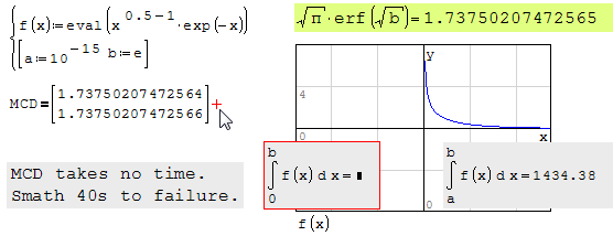

#9 Опубликовано: 28.01.2023 10:46:03
For short calculations it's a good alternative, but it seems very-very slow when long iterations are needed.
In some instances, Smath is slightly faster than Mathcad 11.
However, almost not observable.
In other instances, Smath is horribly slow.
1 min Julia in Mathcad takes over 2 hrs in Smath
Same observation Fourier CoC ... and more.
Please, attach your document for Smath Community to doctor.

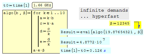

#10 Опубликовано: 28.01.2023 11:09:26
I have attached my histogram again, revised it a bit and commented it.
Actually I think it does exactly what it should, but I have to admit
that I don't know the exact definition of a histogram 8)
Your document does not open 'incorrect format'
Visit Wikipedia for Histogram.
#11 Опубликовано: 28.01.2023 11:50:23
SMath may not be fastest among them.
But some tricks can be applied.
It may improve calc speed slightly.

#18 Опубликовано: 29.01.2023 10:41:06
Maths algo DEMANDS.sm (5,85 КиБ) скачан 1281 раз(а).
