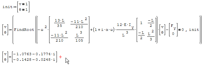

FindRoots ignores Units. Code the image first.
Solve FindRoots Complex Forum.sm (11.09 KiB) downloaded 1307 time(s).

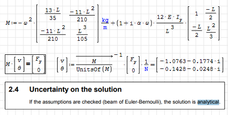

In order to be able to add the two terms they must have the same units. However, omega^2*L doesn't have the same units as EI/L^3. The omega^2*... term seems to be missing a linear mass density (kg/m).
The fact that you might be able to get a numerical result by simply removing the units is irrelevant.

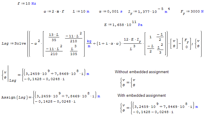

Besides correction of the unit mismatch, Solve seems to want the matrix equation in homogeneous form.
Matrix equation_Kr.sm (14.1 KiB) downloaded 1232 time(s).

Hi. Another way.
