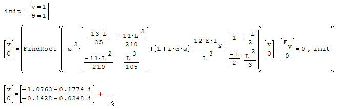

FindRoots ignores Units. Code the image first.
Solve FindRoots Complex Forum.sm (11.09 KiB) downloaded 1481 time(s).

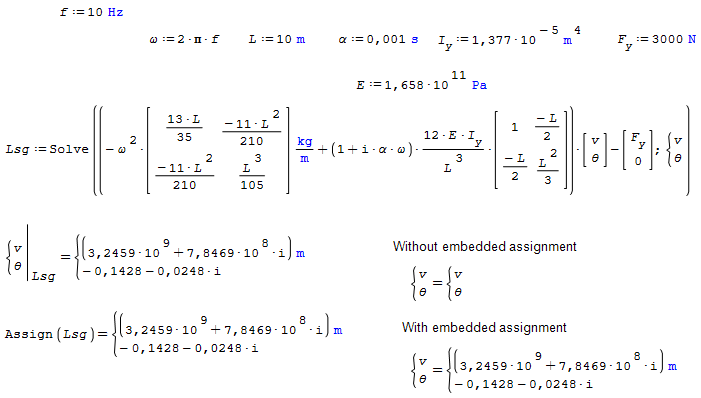

Besides correction of the unit mismatch, Solve seems to want the matrix equation in homogeneous form.
Matrix equation_Kr.sm (14.1 KiB) downloaded 1414 time(s).

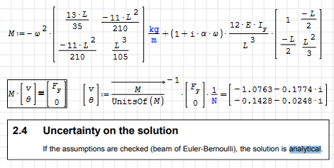

Hi. Another way.
