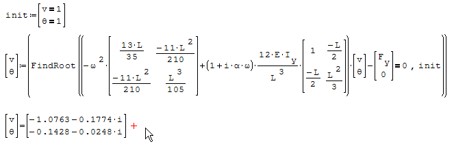

I'd like to solve the following equation involving matrices for unknown v and θ:
After inputting it in the format used by the Maxima plug-in I get the "no result" message:
Am I doing something wrong ?

FindRoots ignores Units. Code the image first.
Solve FindRoots Complex Forum.sm (11,09 КиБ) скачан 1481 раз(а).

Thank you, I didn't know that I should use the Nonlinear Solvers plug-in instead of the Maxima one.
It works now but the result is surprising. It should be something like v = - 0.021020 for the real part with this input data.

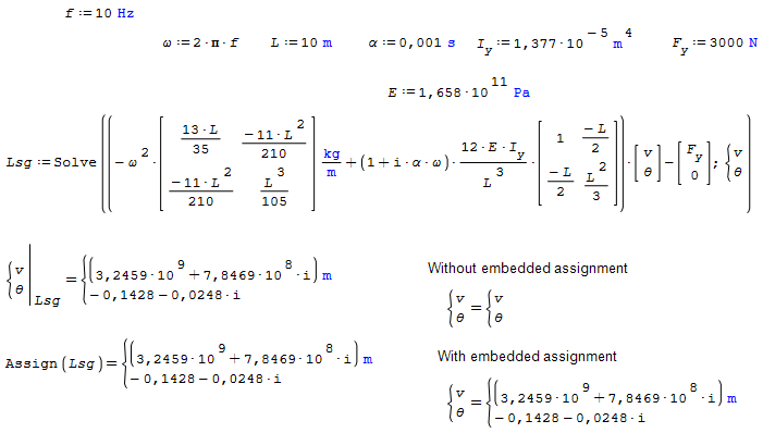

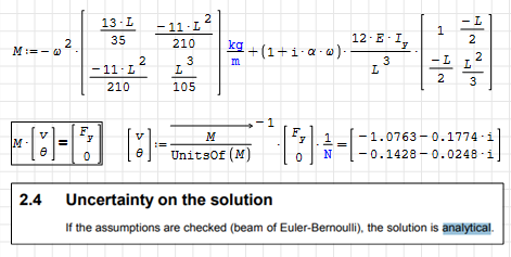

Besides correction of the unit mismatch, Solve seems to want the matrix equation in homogeneous form.
Matrix equation_Kr.sm (14,1 КиБ) скачан 1414 раз(а).
