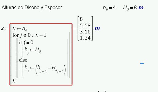

Hello guys, please your help! I've trying for weeks to do the equivalent WHILE in Smath Studio... a big tool for me. But I really cant figure it out, after watching thousands of videos and web pages. This might be a dumb question, but I'm kinda desperate.
I keep getting Z is not defined.
See the following captures:
Mathcad
Smath Studio
Thank you very much in advance.

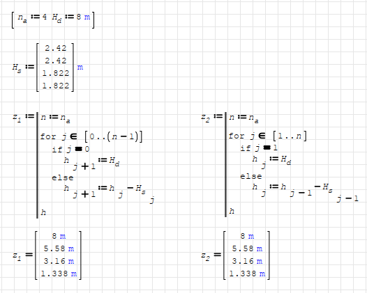

#2 Posted: 2021/9/7 17:36:04
598 likes in 1,380 posts.
SMath vectors/matrices don't start with 0 index.
First matrix/vector element gets the index 1.
Redesigning your code should make it tick.
Either make your indexes +1 or change your range to start with 1.

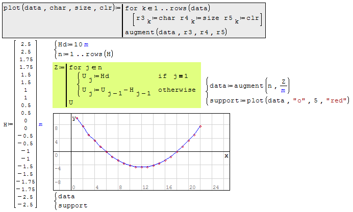

#4 Posted: 2021/9/8 16:35:53
Does it make sense to sanity Smath vs Mathcad more generally ?
Page9 Sanity Mathcad.sm (8.19 KiB) downloaded 1242 time(s).
#5 Posted: 2021/9/10 02:12:09
wty3000
wty3000
0 likes in 5 posts.
when I download the attachment, run it,
the error happens : "j is not defined"
Is it my PC's problem?
#6 Posted: 2021/9/10 19:12:50
PC problem ? Maybe as no visitor reported problem.

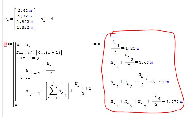

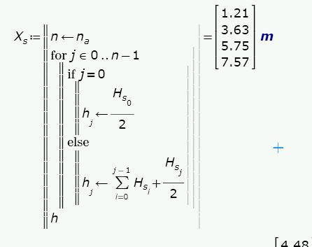

#9 Posted: 2021/9/14 17:05:39
metrvg
metrvg
0 likes in 5 posts.
Guys, thanks for your advices, i've been progressing with Smath... BUT, I reached a new issue... and I still don't get it...
i even did the calls step by step marked in red.
What can be wrong in the sintax??
Check this out:
Mathcad
Smath
Thank you very much in advance!

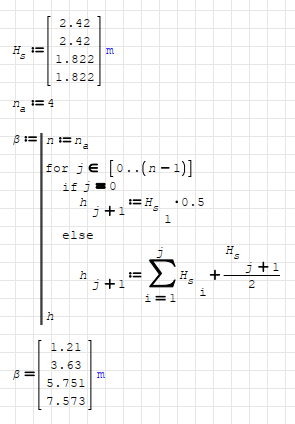

#10 Posted: 2021/9/14 17:25:05
What can be wrong in the syntax??
We can't really tell what is the matter without the file.
I guess you tried to see the result in same region with the algorithm.
Same region result evaluation won't work with multi-line calculations.
But it will give you the correct results in a separate evaluation.
The syntax seems to appear correct. There is no problem with syntax.
When I wrote everything as you did, it just works.
Here is your algorithm written from scratch.
syntax.sm (5.16 KiB) downloaded 1114 time(s).
