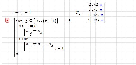

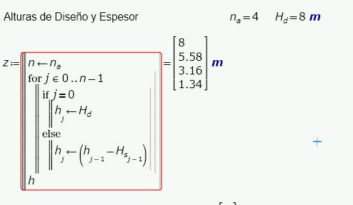

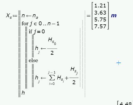

Hello guys, please your help! I've trying for weeks to do the equivalent WHILE in Smath Studio... a big tool for me. But I really cant figure it out, after watching thousands of videos and web pages. This might be a dumb question, but I'm kinda desperate.
I keep getting Z is not defined.
See the following captures:
Mathcad
Smath Studio
Thank you very much in advance.

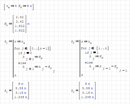

SMath vectors/matrices don't start with 0 index.
First matrix/vector element gets the index 1.
Redesigning your code should make it tick.
Either make your indexes +1 or change your range to start with 1.

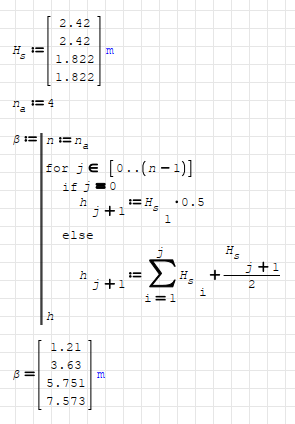

The mountains of Mathcad that I converted for Smath were done simply.
1. From the Mathcad default index 0, save the result.
2. set Mathcad ORIGIN 1
3. Run the program, doctor as indicated by the red message.
I still have a gorgeous Mathcad ORIGIN 0 that couldn't be
converted/doctored ORIGIN 1 ... Damned mystic to me !
Cheers ... Jean.

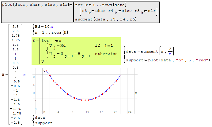

#4 Опубликовано: 08.09.2021 16:35:53
Does it make sense to sanity Smath vs Mathcad more generally ?
Page9 Sanity Mathcad.sm (8,19 КиБ) скачан 1436 раз(а).

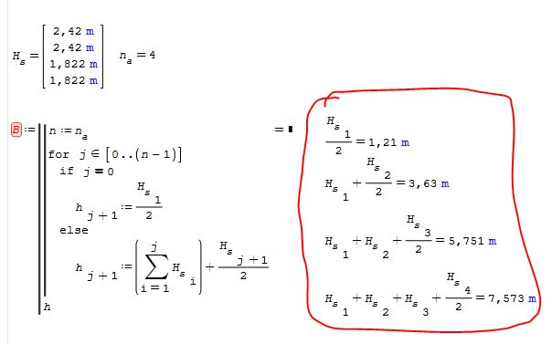

Guys, thanks for your advices, i've been progressing with Smath... BUT, I reached a new issue... and I still don't get it...
i even did the calls step by step marked in red.
What can be wrong in the sintax??
Check this out:
Mathcad
Smath
Thank you very much in advance!
#10 Опубликовано: 14.09.2021 17:25:05
What can be wrong in the syntax??
We can't really tell what is the matter without the file.
I guess you tried to see the result in same region with the algorithm.
Same region result evaluation won't work with multi-line calculations.
But it will give you the correct results in a separate evaluation.
The syntax seems to appear correct. There is no problem with syntax.
When I wrote everything as you did, it just works.
Here is your algorithm written from scratch.
syntax.sm (5,16 КиБ) скачан 1276 раз(а).
