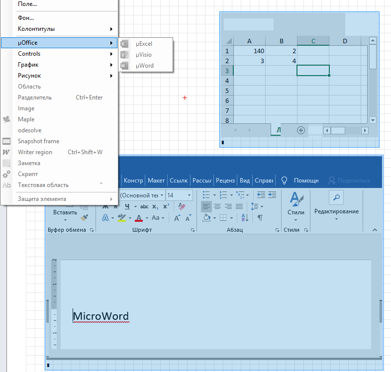

MicroOffice [ β ]
SMath Viewer compatibility mono compatibility Sources
Implementation started.
I don't know how, but I think it is possible to show office documents as images. For editing we can open Word, Excel or Visio as external editors. Documents can be embedded to worksheet.
frapuano 2019/8/16 03:02:00, Arie 2019/8/16 16:10:00, Николай Цопа 2020/3/22 14:10:00

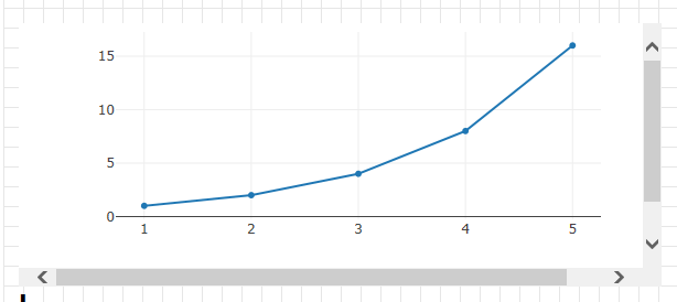

Using this technique it is possible to use the Plotly.js library to draw graphs. Basically, this method allows you to access the usual form, but with limited interaction.

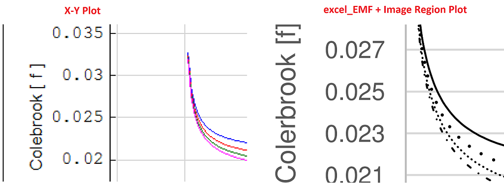

But it is also shown as object and pdf-friendly.
smath.pdf (64.2 KiB) downloaded 1001 time(s).

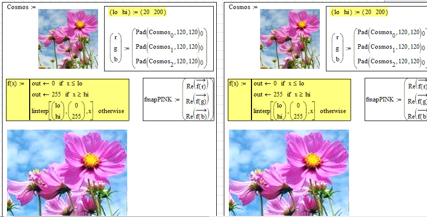

#7 Posted: 2019/9/29 20:07:19
If I make an Smath PDF as captured, PDF is 1/1
My PDF is CutePDF freeware, NOT Smath PDF.
...open with Adobe Reader [the freeware]
Images captured/crop as described earlier,
pasted in Smath, Smath => CutePDF
Type T_J.pdf (399.6 KiB) downloaded 916 time(s).

At right is the original in Smath document.
At left is the 100% Adobe, copied/pasted.
#12 Posted: 2019/9/30 11:18:02
Smath document.
PDF Cosmos Test.sm (711.28 KiB) downloaded 1549 time(s).
After this post, I will re-download check.
