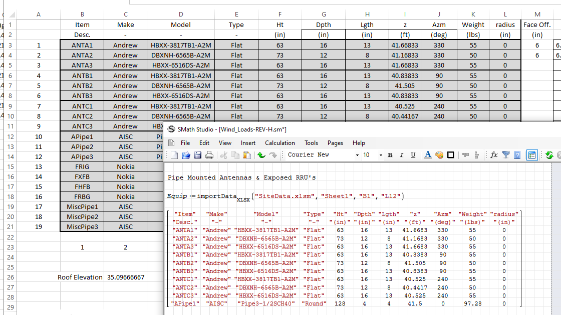

overlord:
are you trying to bring in a chart or data table into SMath? your original post referred to table data.
can you use Alex's EXCEL I/O plug in to read in the table directly?
i use it to grab arrays out of excel. with a bit of clever formatting, you can bring in units as well if they are syntaxed correctly.
i find it MUCH easier to edit and manipulate arrays in Excel than in SMath.
here is a snip with SMath and the excel sheet it imports from below.

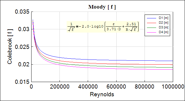

WroteNote the difference of as-printed quality between X-Y Plot output and excel_EMF output.
X-Y Plot has no pixelation now (this was fixed a year ago.).
WroteX-Y Plot has no pixelation now (this was fixed a year ago.).
Easy otherwise pixelation [when convenient].
Caliper the plot width to length of data set.
That one does not fit my small screen.
Copy image, paste in IrfanView to recover quality.
WroteWroteNote the difference of as-printed quality between X-Y Plot output and excel_EMF output.

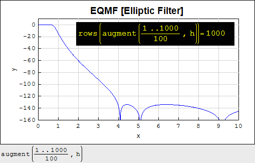

Pure tip to plot points as symbol, superposed/overposed
over other range of data on same X_Y trace.
Example: Isometric just posted [too small screen to caliper].
Wrotei have just used it for an easy examle of displaying excel with no quality loss
You mean: compare X_Y vs Excel ... X_Y of equal fineness ?
Post the maths that plot X_Y ... looks interesting.
Maybe convincing.
