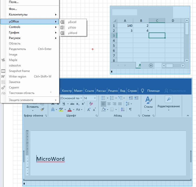

I don't know how, but I think it is possible to show office documents as images. For editing we can open Word, Excel or Visio as external editors. Documents can be embedded to worksheet.

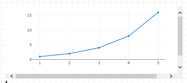

Using this technique it is possible to use the Plotly.js library to draw graphs. Basically, this method allows you to access the usual form, but with limited interaction.

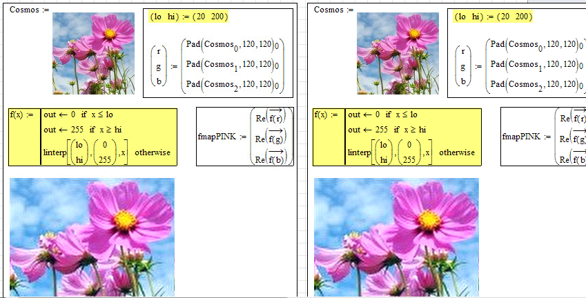

#10 Posted: 9/30/2019 10:16:06 AM

#11 Posted: 9/30/2019 11:10:48 AM
Please zoom in both pdf. You will see they are not same.
Your last example has the same diseas, if you zoom in to your cosmos.pdf you will see.
Texts in cropped images are not looking good at pdf and paper.
At right is the original in Smath document.
At left is the 100% Adobe, copied/pasted.
#12 Posted: 9/30/2019 11:18:02 AM
Smath document.
PDF Cosmos Test.sm (711.28 KiB) downloaded 1769 time(s).
After this post, I will re-download check.
