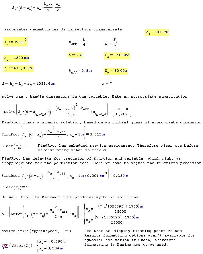

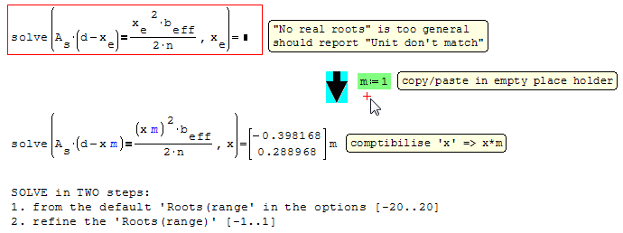

"NO real roots" from the solve bloc is an absolute pest [not to say stupid].
SMath_equation solver test (1).sm (11.49 KiB) downloaded 1314 time(s).

With regards to your responses, I appreciate the need to make an appropriate substitution to overcome the fact that solve can't handle units in the variable; However, I can´t seem to assign the unit to the variable, within the equation (apologies for being thick). I've tried typing x'm, tried using ctrl+w to assign meters unit to x, but still haven't managed to make it work. A bit frustrating... If anyone could be so kind to shed some light here, that would be greatly appreciated.
Many thanks,
J

Type x*'m or x* and then insert the unit from the dialog into the empty placeholder in the right of the multiplication dot.
Multiplication operators in front of units aren't shown.

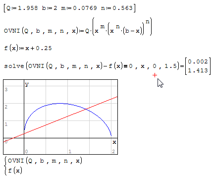

Always plot first ...

0 likes in 4 posts.
it works on wolfram and symbolab, but not in Smath.
I somehow missed the option to use the 2nd solve function with root limit, but I didn't need a plot for this, so I used it in one line and everything worked out fine.
I can't click the thank button, so thanks.
#18 Posted: 2019/12/29 23:01:26
If you don't plot, you will soon hit the wall.
That will help set the limits.
When applicable, "implicit roots" is often + accurate.
