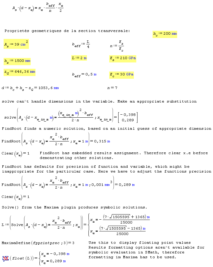

I am relatively new to SMath (have used Mathcad in the past). I am trying to use SMath to run some engineering calculations. Particularly, I am interested in solving equations - I have used 'solve' function, but always get a "no real roots" message (see file attached).
Can someone help out?

With regards to your responses, I appreciate the need to make an appropriate substitution to overcome the fact that solve can't handle units in the variable; However, I can´t seem to assign the unit to the variable, within the equation (apologies for being thick). I've tried typing x'm, tried using ctrl+w to assign meters unit to x, but still haven't managed to make it work. A bit frustrating... If anyone could be so kind to shed some light here, that would be greatly appreciated.

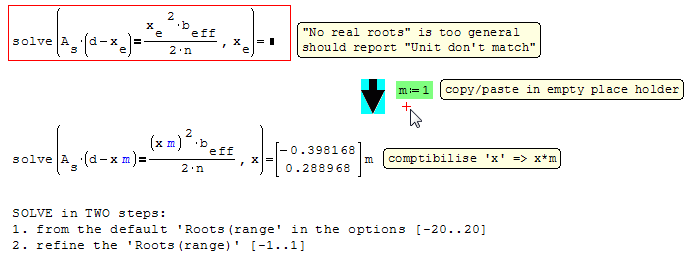

Type x*'m or x* and then insert the unit from the dialog into the empty placeholder in the right of the multiplication dot.
Multiplication operators in front of units aren't shown.

You are debating with the Unit SI as implemented in Smath [Mathcad ...]
You may pacify your soul on several counts:
1. maths are unit less
2. ISO standards have their own units [most generally from SI derived units].
... therefore converting automatically bar in Pa ... etc.
3. Engineering formulas are constructed around the appropriate Units
... therefore no need to freak them more.
4. Consider this example: you have a formula, from which you can directly/indirectly
compute the arc length ... in what SI units Watson ???
... simple Sherlook ... in "UnitGraphic" that you can meter in year-light/micrometer ...
5. How did we do in the age of the slide rule, in the age of paper/pencil/log tables ?
6. Was Sputnik launched from SI unit software ?

If you don't plot, you will soon hit the wall.
That will help set the limits.
When applicable, "implicit roots" is often + accurate.
