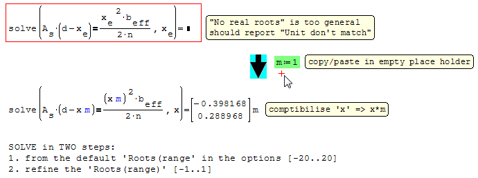

I am relatively new to SMath (have used Mathcad in the past). I am trying to use SMath to run some engineering calculations. Particularly, I am interested in solving equations - I have used 'solve' function, but always get a "no real roots" message (see file attached).
Can someone help out?

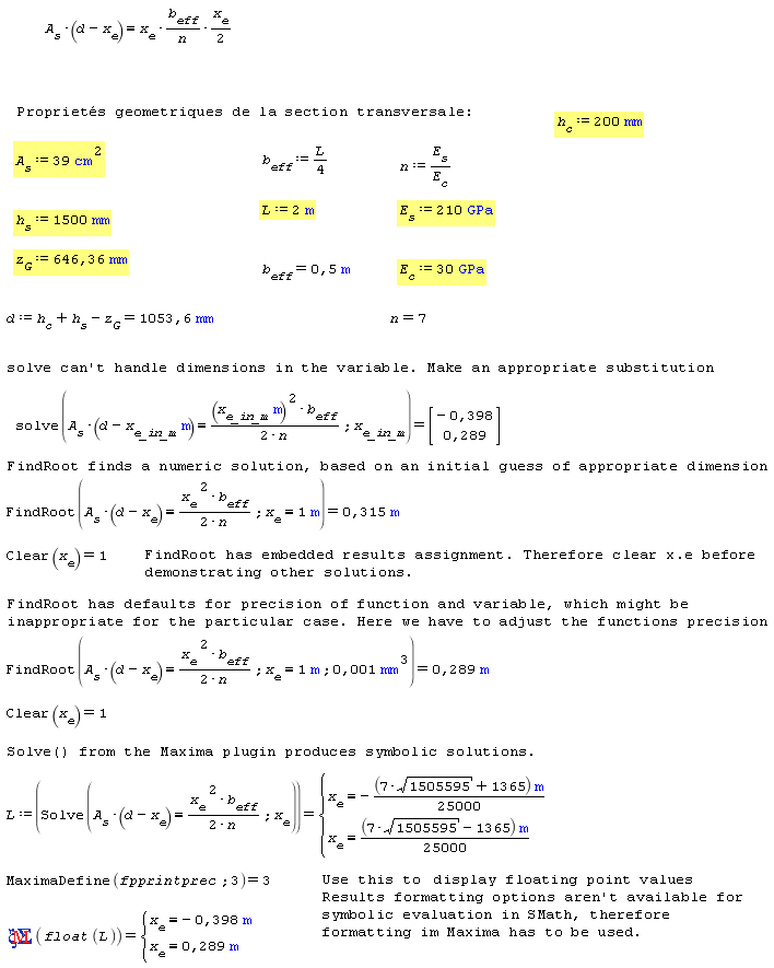

Iff someone could have a look at the .sm file I have attached, I would be very grateful.
Many thanks,
Joao
SMath_equation solver test.zip (1,59 КиБ) скачан 547 раз(а).
SMath_equation solver test.sm (8,23 КиБ) скачан 1472 раз(а).

solvers.sm (17,78 КиБ) скачан 1453 раз(а).

"NO real roots" from the solve bloc is an absolute pest [not to say stupid].
SMath_equation solver test (1).sm (11,49 КиБ) скачан 1414 раз(а).

With regards to your responses, I appreciate the need to make an appropriate substitution to overcome the fact that solve can't handle units in the variable; However, I can´t seem to assign the unit to the variable, within the equation (apologies for being thick). I've tried typing x'm, tried using ctrl+w to assign meters unit to x, but still haven't managed to make it work. A bit frustrating... If anyone could be so kind to shed some light here, that would be greatly appreciated.
Many thanks,
J
#13 Опубликовано: 07.03.2018 13:08:03
Dear ALL,
Many thanks for your incredible support! I am in awe for the depth of knowledge herein displayed.
Many thanks,
J
Type x*'m or x* and then insert the unit from the dialog into the empty placeholder in the right of the multiplication dot.
Multiplication operators in front of units aren't shown.

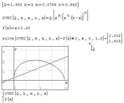

I'm having a similar problem, it works on wolfram and symbolab, but not in Smath.
#16 Опубликовано: 28.12.2019 23:32:16
Always plot first ...

I somehow missed the option to use the 2nd solve function with root limit, but I didn't need a plot for this, so I used it in one line and everything worked out fine.
I can't click the thank button, so thanks.
#18 Опубликовано: 29.12.2019 23:01:26
If you don't plot, you will soon hit the wall.
That will help set the limits.
