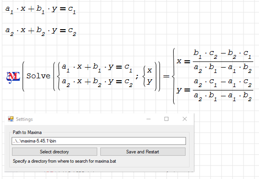

Such as this
a.1*x+b.1*y≡c.1
a.2*x+b.2*y≡c.2
How to get symbolic results for x and y
1.sm (3.01 KiB) downloaded 720 time(s).

Hi, It's posible whith Maxima Plugin
netsonicyxf 2022/2/12 22:27:00
Make it immediately usable.

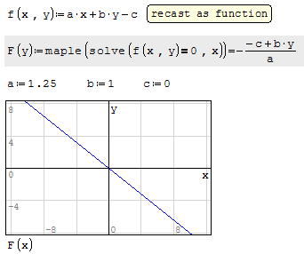

... get lot more from maple companion.
ODE Symbolic Verhulst [Logistic].sm (25.55 KiB) downloaded 614 time(s).

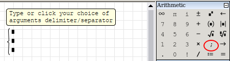

How to input more than 2 equations in Solve after curly brace?
There are only 2 placeholders by default.

No, I mean the equations after {
#8 Posted: 2022/2/13 11:12:14
netsonicyxf
netsonicyxf
2 likes in 79 posts.
The { is a function built-in SMath, it's called "System of variables or equations".
It's located in the Function side panel.
#9 Posted: 2022/2/13 11:27:27

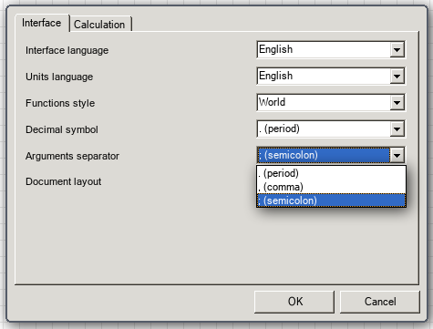

580 likes in 1,348 posts.
This includes expanding vectors, adding new arguments to functions, etc.
netsonicyxf 2022/2/13 11:28:00
