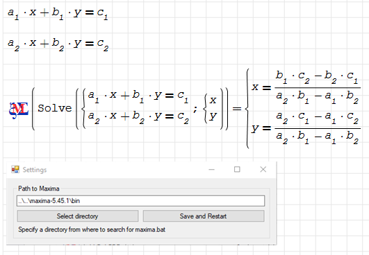

Such as this
a.1*x+b.1*y≡c.1
a.2*x+b.2*y≡c.2
How to get symbolic results for x and y
1.sm (3,01 КиБ) скачан 1327 раз(а).
#2 Опубликовано: 12.02.2022 10:53:27
oscar mauricio
oscar mauricio
1 сообщений из 10 понравились пользователям.
Hi, It's posible whith Maxima Plugin
netsonicyxf 12.02.2022 22:27:00

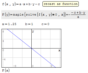

... get lot more from maple companion.
ODE Symbolic Verhulst [Logistic].sm (25,55 КиБ) скачан 1131 раз(а).

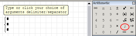

How to input more than 2 equations in Solve after curly brace?
There are only 2 placeholders by default.

No, I mean the equations after {
#8 Опубликовано: 13.02.2022 11:12:14
netsonicyxf
netsonicyxf
2 сообщений из 79 понравились пользователям.
The { is a function built-in SMath, it's called "System of variables or equations".
It's located in the Function side panel.

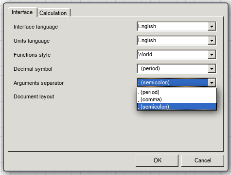

#9 Опубликовано: 13.02.2022 11:27:27
This includes expanding vectors, adding new arguments to functions, etc.
netsonicyxf 13.02.2022 11:28:00
