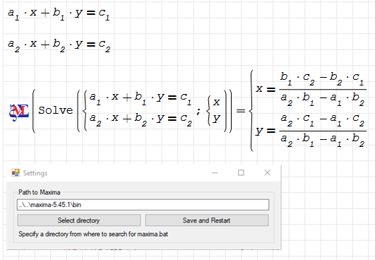

Such as this
a.1*x+b.1*y≡c.1
a.2*x+b.2*y≡c.2
How to get symbolic results for x and y

Hi, It's posible whith Maxima Plugin
netsonicyxf 2/12/2022 10:27:00 PM
#3 Posted: 2/12/2022 11:38:38 AM

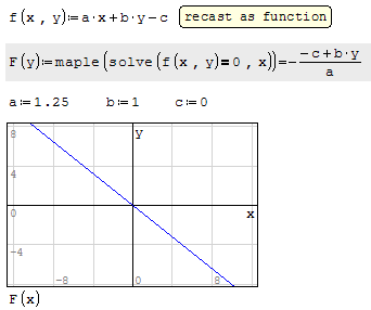

... get lot more from maple companion.
ODE Symbolic Verhulst [Logistic].sm (25.55 KiB) downloaded 1051 time(s).

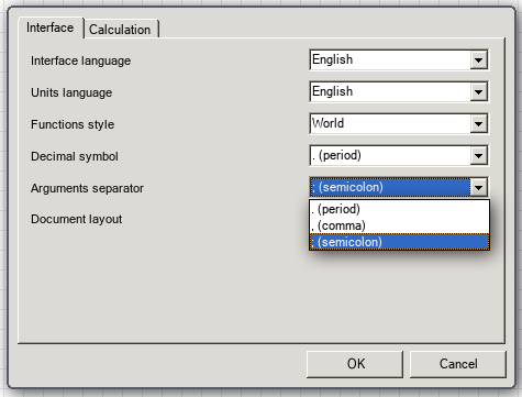

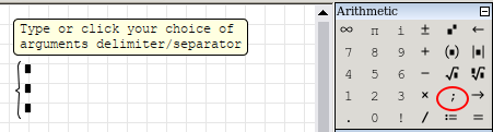

How to input more than 2 equations in Solve after curly brace?
There are only 2 placeholders by default.

No, I mean the equations after {
#8 Posted: 2/13/2022 11:12:14 AM
netsonicyxf
netsonicyxf
2 likes in 79 posts.
The { is a function built-in SMath, it's called "System of variables or equations".
It's located in the Function side panel.
#9 Posted: 2/13/2022 11:27:27 AM
598 likes in 1,380 posts.
This includes expanding vectors, adding new arguments to functions, etc.
netsonicyxf 2/13/2022 11:28:00 AM
