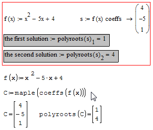

Hello.
Thank you Jean Giraud for the indications of solving the second degree polynomial equation. But the issue that bothers me is that of variable assignment: "the first solution" & "the second solution". So how do this assignment in SMath?
All the best.
#83 Posted: 12/23/2017 5:58:33 AM
1,443 likes in 2,936 posts.
You can only without spaces in the variable name
#84 Posted: 12/23/2017 6:12:36 AM
Nicolae Olaru
Nicolae Olaru
1 likes in 115 posts.
Greetings.
Thank you, Davide.
Relative to post # 81. I'm sorry Jean Giraud, but I did not find the functions "coeffs" and "maple" defined in the "Insert - Function" menu. I have installed SMath Studio 0.98.6484 portable version. I searched for updates that do not exist. I'm waiting for explanations, or guidelines for defining these functions in user mode.
#85 Posted: 12/23/2017 6:36:26 AM
Many functions/regions are available through third-party plugins, not provided within the installer; these are available in the extensions manager, under Tools > Plugins... > [Local Storage > Online Gallery]
Usually you can find documentation about them in this section of the forum (Extensions) or in the interactive book of Martin Kraska (again in the extensions manager, interactive books section); function maple is from the maple plugin

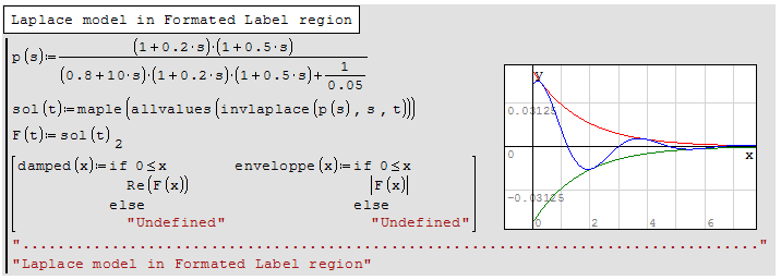

#96 Posted: 8/1/2018 7:05:05 PM
... like this ?

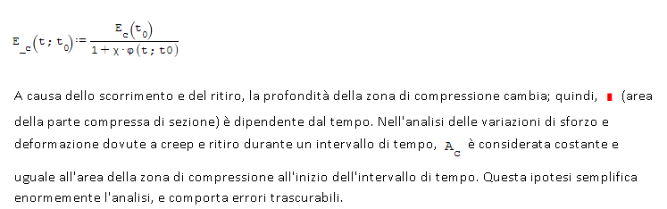

Lately I have encountered the following problem. When a previously saved file is reopened without any apparent inconvenience, some Math objects appear lost (in their place the red square). Everything seems random because other math objects in the same file and in the same wrirer region are correct. Does it happen to you too?
Smath Ver 0.99 build 6671 on Win7 64bit
Davide Carpi 8/22/2018 7:20:00 AM
#98 Posted: 8/22/2018 7:19:50 AM
Reproduced, thank you Sergio (problem appears to be about the serialization of subscripts).
edit: this is a more general bug of the program, issue opened as SS-3549
sergio 8/22/2018 7:30:00 AM
