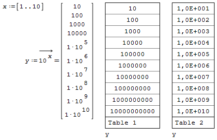

I do think it would also be good to consider (optionally) using the common exponent notation for display as it is much more compact in arrays. When an array is full of *10^3 it really blows out the size on the page.
How about the Table region?
sci.sm (13.5 KiB) downloaded 914 time(s).
Alvaro 2020/8/28 05:33:00
That's a useful solution. I see that when scientific is selected, however, that it loses the units.
Is the table plugin part of the closed source, or an open source add on that might be fixable?
[is it: https://smath.info:8443/!/#public/view/head/plugins/TableRegion ?]
However, I would just prefer to have numeric formatting work well in the first place.
The plugin is open source, just like all third-party plugins.
WroteIs the table plugin part of the closed source, or an open source add on that might be fixable?
Table region is part of the SS download as old as SS 6179.
Fix what to this superb delivery ?
WroteI see that when scientific is selected, however, that it loses the units.
It does not lose what's not specified.
Table Scientific.sm (20.56 KiB) downloaded 980 time(s).
