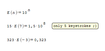

#3 Posted: 5/17/2018 12:42:41 PM
Oscar Campo
Oscar Campo
135 likes in 309 posts.
It would really help to have a fast way of entering powers of ten.
In electronics, every number has a large exponent and entering 15 * 10 ^ 7 is harder than 15E7
(8 keystrokes vs 4)
Alternatives: use ctrl+E or alt+E as simple keystroke macro to insert: *10^
Alternative: Define a function E()

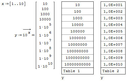

#9 Posted: 8/27/2020 11:49:20 AM
1,361 likes in 2,275 posts.
I do think it would also be good to consider (optionally) using the common exponent notation for display as it is much more compact in arrays. When an array is full of *10^3 it really blows out the size on the page.
How about the Table region?
sci.sm (13.5 KiB) downloaded 1666 time(s).

#10 Posted: 8/28/2020 2:31:05 AM

#11 Posted: 8/28/2020 3:51:11 AM

#13 Posted: 8/29/2020 10:36:56 AM
I see that when scientific is selected, however, that it loses the units.
It does not lose what's not specified.
Table Scientific.sm (20.56 KiB) downloaded 1739 time(s).
