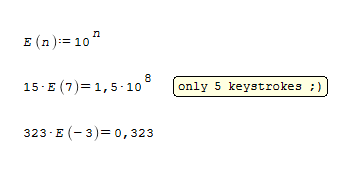

Alternative: Define a function E()

Make your own feature to suit peculiar project.
This notation is native in OriginLab.
Maths e(n).sm (14,94 КиБ) скачан 1668 раз(а).

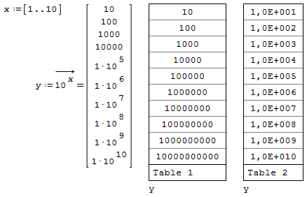

How about the Table region?
sci.sm (13,5 КиБ) скачан 1665 раз(а).

That's a useful solution. I see that when scientific is selected, however, that it loses the units.
Is the table plugin part of the closed source, or an open source add on that might be fixable?
[is it: https://smath.info:8443/!/#public/view/head/plugins/TableRegion ?]
However, I would just prefer to have numeric formatting work well in the first place.

#13 Опубликовано: 29.08.2020 10:36:56
It does not lose what's not specified.
Table Scientific.sm (20,56 КиБ) скачан 1738 раз(а).
