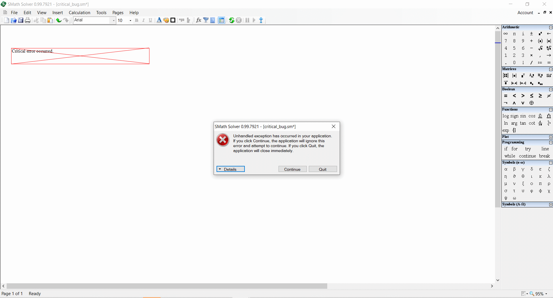

Eventually I have caught a bug that bothered me in a few latest versions of Smath.
critical_bug.sm (3.85 KiB) downloaded 949 time(s).

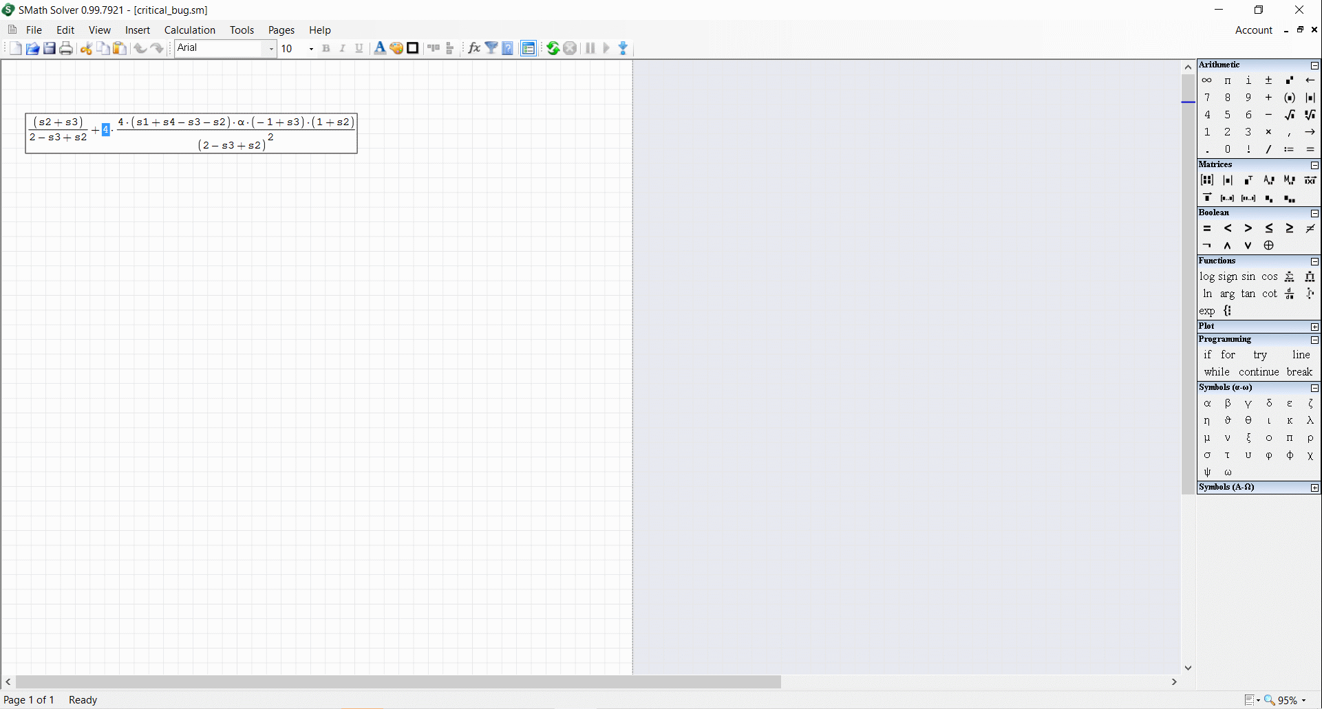

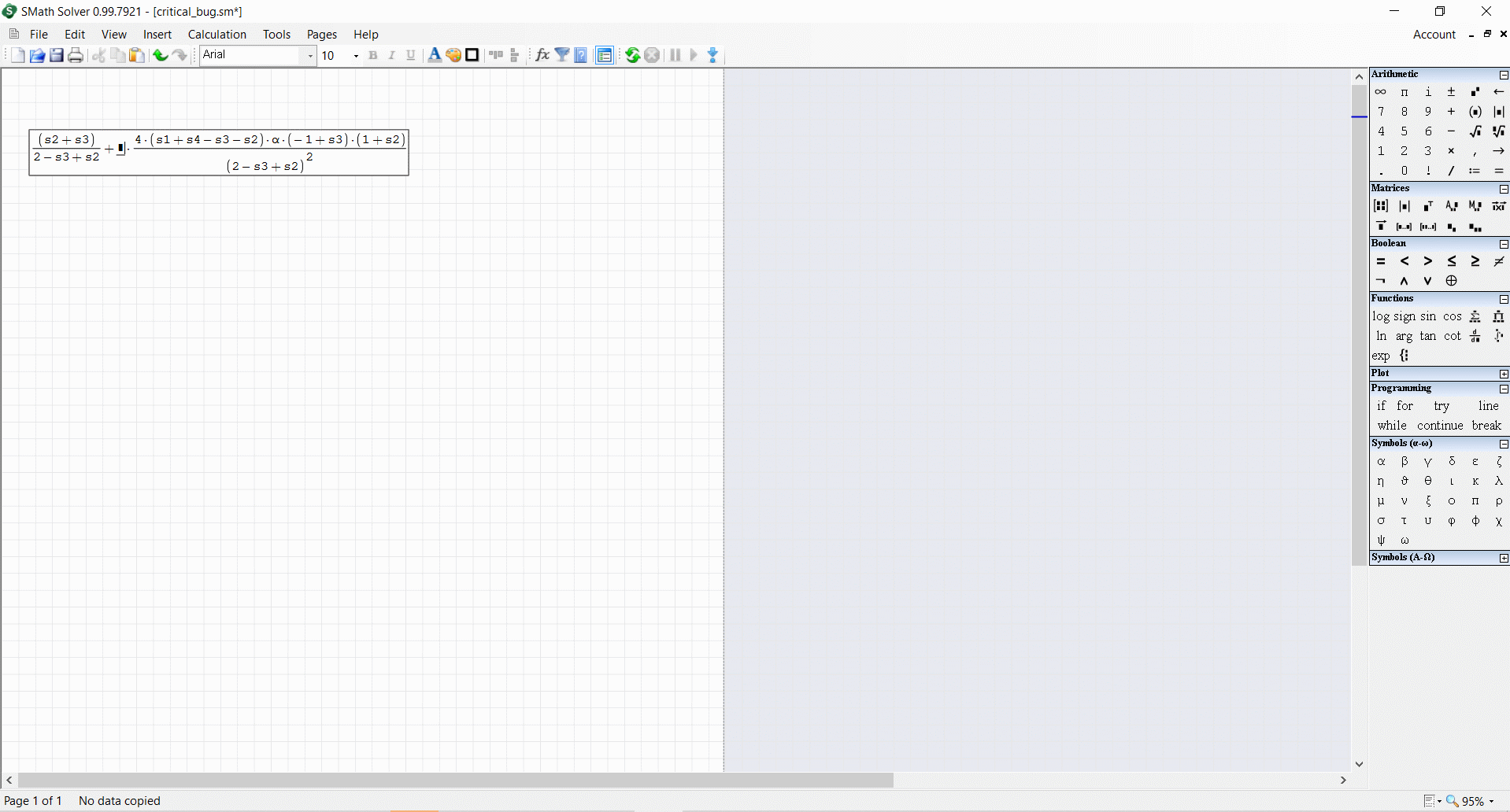

Try to delete the first number "4" in front of the ratio.
Step 1: Select it with the cursor.
Show Spoiler
Step 2: Press "Del", the "4" turns into a black square.
Show Spoiler
Step 3: Press "Del" once again. SM pops on "Critical error".
Show Spoiler

I can also confirm the existence of this issue ( "v0.99.7921.69" ). Upon investigation, I have (2) items:
  1) The program does not actually 'crash', the program is still running. Thus: you can recover from this bug without losing all your work!
      a) To recover from this error:
            1) On the " Unhandled exception has occurred ... Index was outside the bounds of the array" popup error message, Click on the button: 「Continue」
            2) 'UNDO' your last action, either via the menu bar: 「Edit」 -> 「 Undo」 or via keypress 「Ctrl」 + 「Z」
            3) Repeat steps #1 and #2 until you achieve a successful 'undo'.
  2) The elements of this error seem to require a grouping operator (e.g., Absolute Value, Parenthesis, Determinant, Square Root, Matrix) that is paired with a fraction/division operation, prepend this with a multiplication statement and you can duplicate the error. See screen capture below:
