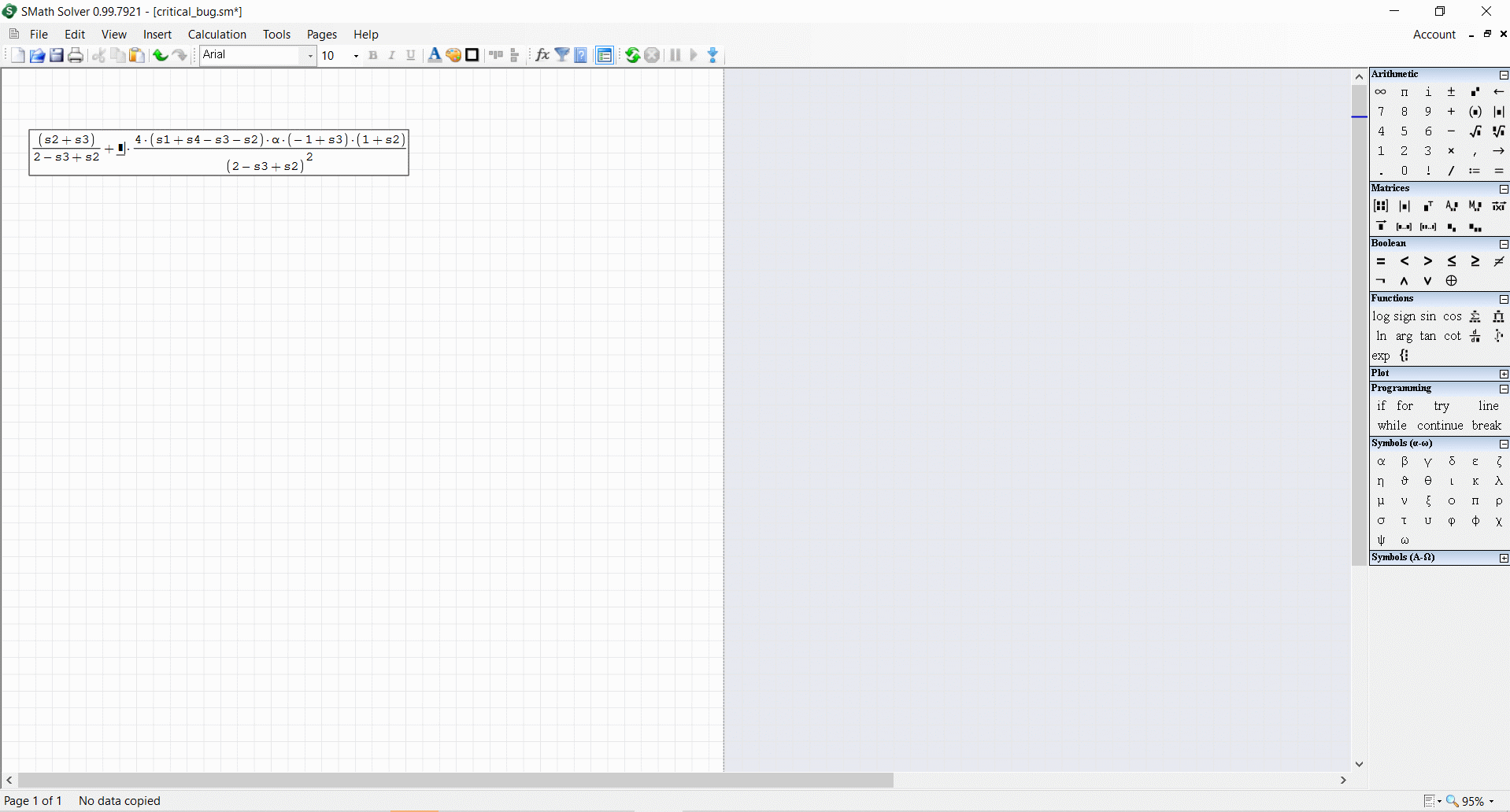

Eventually I have caught a bug that bothered me in a few latest versions of Smath.
critical_bug.sm (3,85 КиБ) скачан 1663 раз(а).
Try to delete the first number "4" in front of the ratio.
Step 1: Select it with the cursor.
Показать спойлер

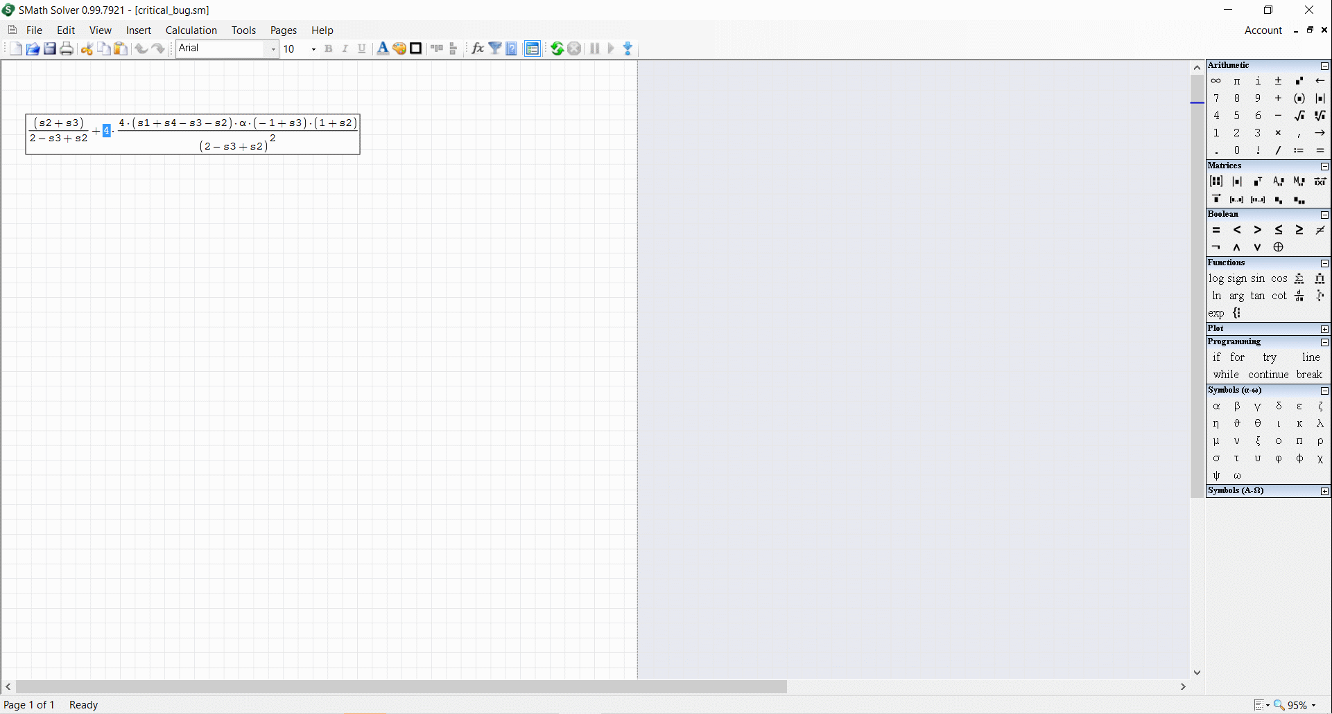

Step 2: Press "Del", the "4" turns into a black square.
Показать спойлер

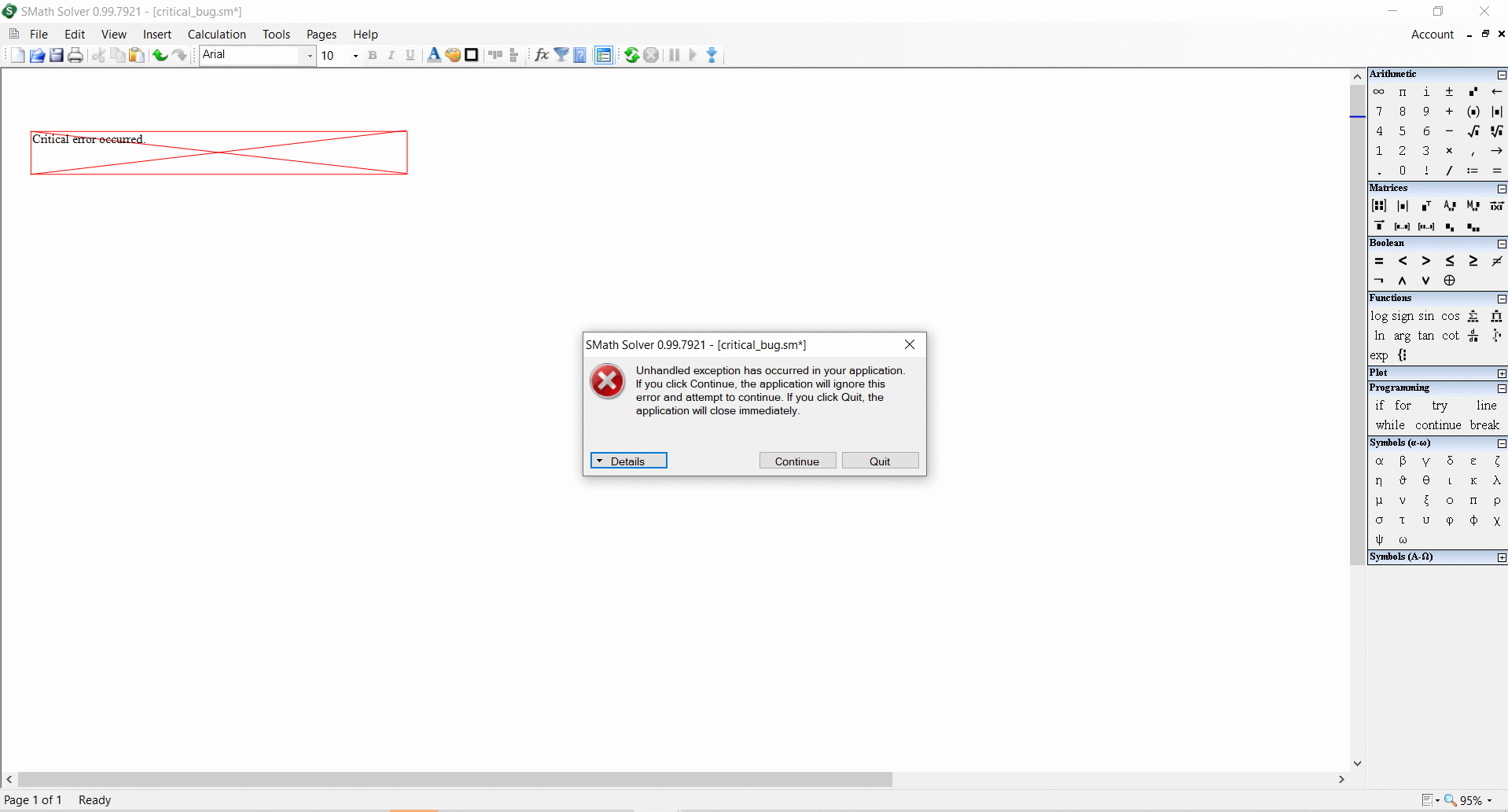

Step 3: Press "Del" once again. SM pops on "Critical error".
Показать спойлер

Thank you, confirmed
System.IndexOutOfRangeException: Index out of matrix bounds.
   in SMath.Controls.MathPainter.PrepareForPaint(MathRegion region, PaintContext ctx, Term[] input, MathAnswer answer, Term[] units, Boolean inputDataVisibility, Int32 currentTermIdx, FontInfo font, Boolean focused, Single& middleLine, Single& baseLine)
   in SMath.Controls.MathRegion.(IGraphics , PaintEventOptions )
   in SMath.Controls.MathRegion.OnCommandSend(String value)
   in SMath.Controls.WorksheetEditor.(RegionBase , String )
   in SMath.Controls.WorksheetEditor.InsertManager(String value)
   in SMath.Controls.Worksheet.Insert(String value)
   in SMath.Controls.WorksheetEditor.KeyDown(KeyEventOptions e)
   in SMath.UI.Accessories.DesktopWorksheet.OnKeyDown(KeyEventArgs e)
   in System.Windows.Forms.Control.ProcessKeyEventArgs(Message& m)
   in System.Windows.Forms.Control.WmKeyChar(Message& m)
   in System.Windows.Forms.Control.WndProc(Message& m)
   in System.Windows.Forms.NativeWindow.Callback(IntPtr hWnd, Int32 msg, IntPtr wparam, IntPtr lparam)

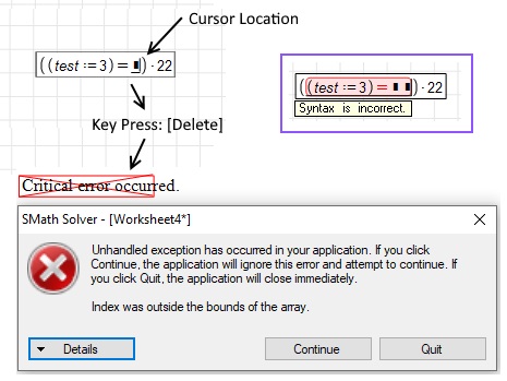

#14 Опубликовано: 23.06.2022 11:31:02
⚜ Kenny Lemens, P.E. ᵂᴵ
Greetings,
I found another configuration that can trigger this error; if you declare/evaluate a variable, and then try to multiply that entire set: you get a syntax error. Now if you attempt to correct the statement by using the [DEL] to remove the evaluation, the error gets thrown (as shown below):
The work around would be to use the [Backspace] to delete/correct the equation, or to copy/paste the terms into a new statement without syntax errors.
-Kenny Lemens, P.E.
