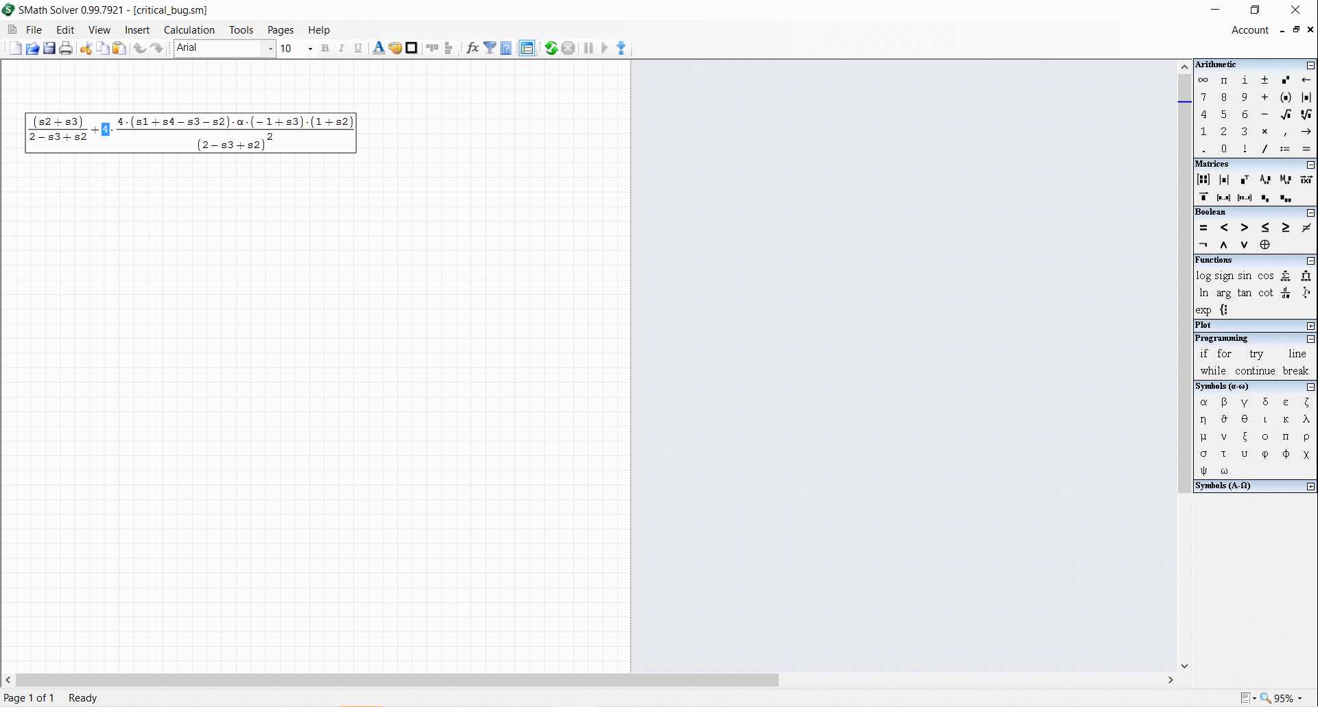

Eventually I have caught a bug that bothered me in a few latest versions of Smath.
critical_bug.sm (3.85 KiB) downloaded 1684 time(s).
Try to delete the first number "4" in front of the ratio.
Step 1: Select it with the cursor.

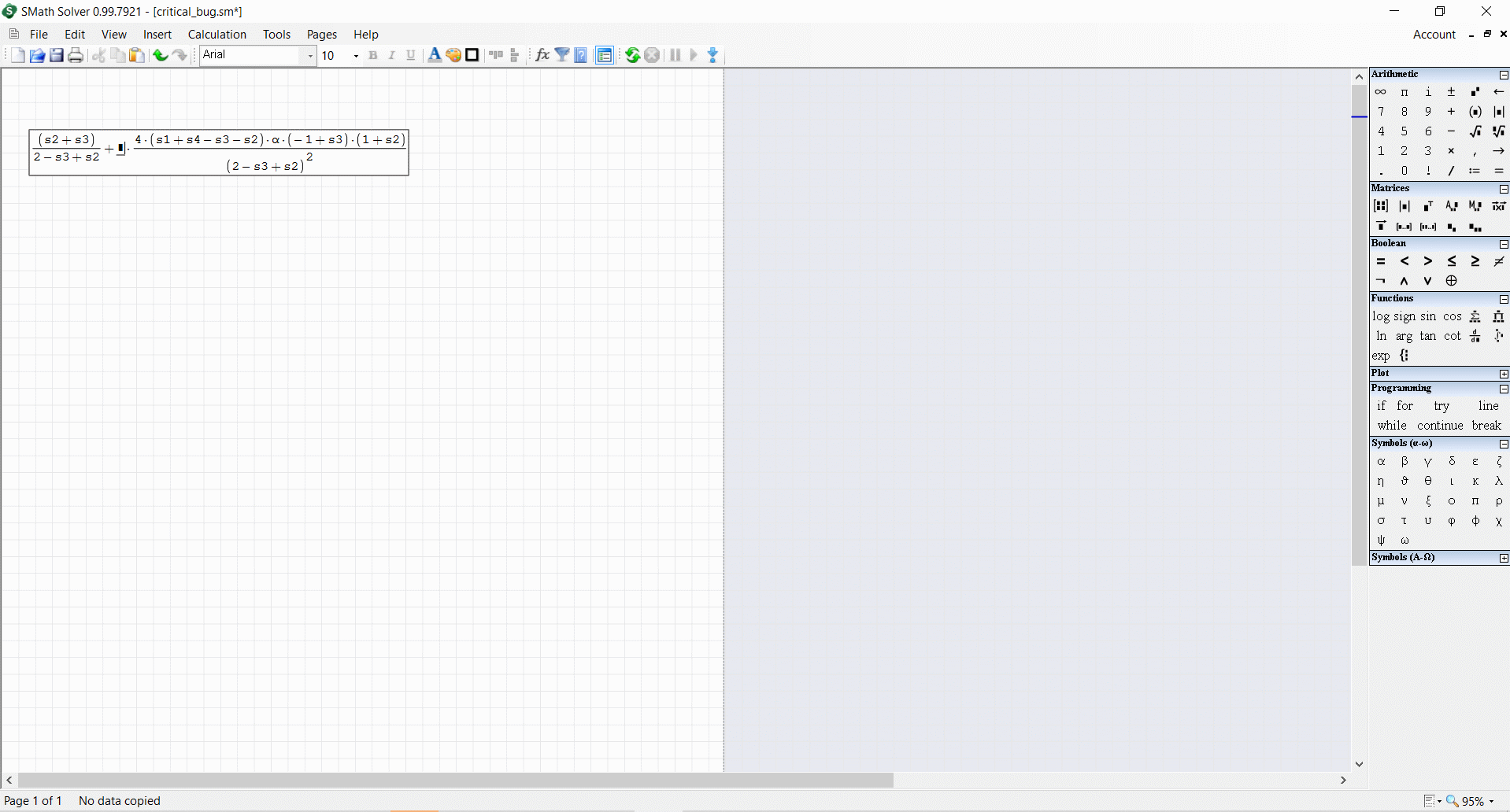

Show Spoiler
Step 2: Press "Del", the "4" turns into a black square.
Show Spoiler

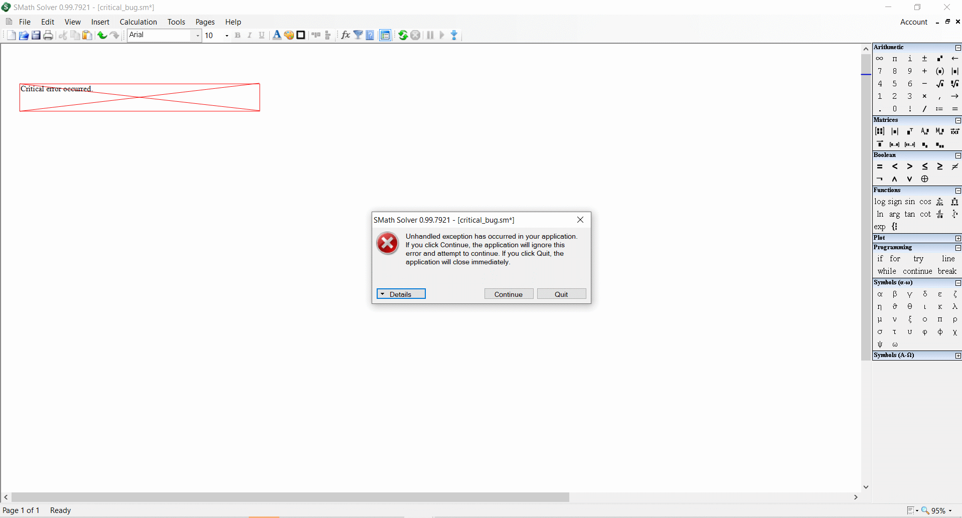

Step 3: Press "Del" once again. SM pops on "Critical error".
Show Spoiler

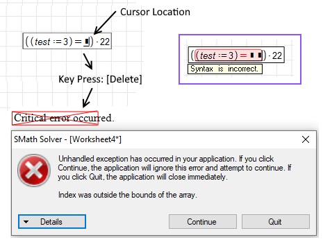

  2) The elements of this error seem to require a grouping operator (e.g., Absolute Value, Parenthesis, Determinant, Square Root, Matrix) that is paired with a fraction/division operation, prepend this with a multiplication statement and you can duplicate the error. See screen capture below:
Below are a few statements I compiled; performing the double-delete on the integer '6' will throw the same error:

I found another configuration that can trigger this error; if you declare/evaluate a variable, and then try to multiply that entire set: you get a syntax error. Now if you attempt to correct the statement by using the [DEL] to remove the evaluation, the error gets thrown (as shown below):
The work around would be to use the [Backspace] to delete/correct the equation, or to copy/paste the terms into a new statement without syntax errors.
