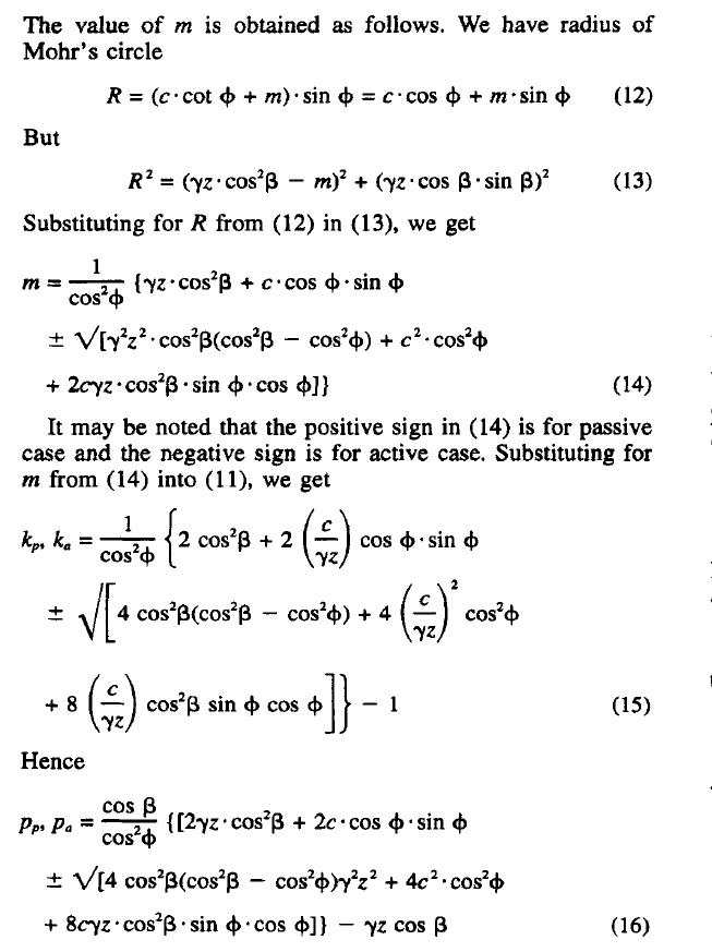

i want to solve below problem
m, ka, pa
i try to solve this problem
but i can't get result.
20230614_lateral earth pressure.sm (100.47 KiB) downloaded 1233 time(s).
Thanks in advance

Hi. Maybe the attached helps, but's hard to know. At the eqn 16 I count two open [ and only one closed ].
20230614_lateral earth pressure.sm (74.8 KiB) downloaded 1244 time(s).

My suggested solution is in the attached.
LateralEarthPressure.sm (9.05 KiB) downloaded 1168 time(s).
Get more accurate solutions from roots(,,,)
LateralEarthPressure.sm (13.13 KiB) downloaded 1191 time(s).

Hi. Another way, plugin-less version. Have the advantage that can recognize the active and passive cases.
Click to enlarge
20230614_lateral earth pressure polyroots.sm (77.28 KiB) downloaded 1194 time(s).
