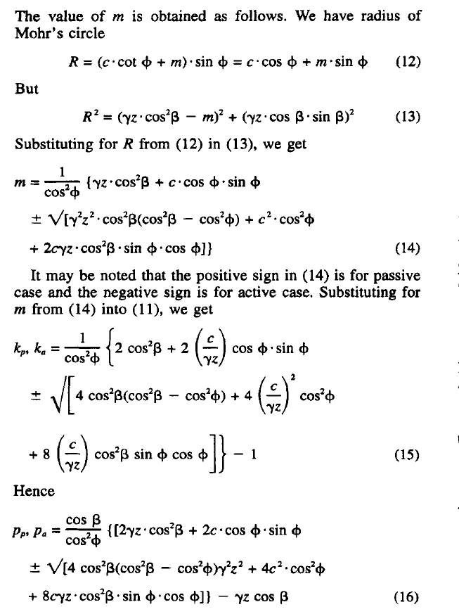

i want to solve below problem
m, ka, pa
i try to solve this problem
but i can't get result.
20230614_lateral earth pressure.sm (100,47 КиБ) скачан 1418 раз(а).
Thanks in advance

Hi. Maybe the attached helps, but's hard to know. At the eqn 16 I count two open [ and only one closed ].
20230614_lateral earth pressure.sm (74,8 КиБ) скачан 1432 раз(а).

My suggested solution is in the attached.
LateralEarthPressure.sm (9,05 КиБ) скачан 1349 раз(а).
Get more accurate solutions from roots(,,,)
LateralEarthPressure.sm (13,13 КиБ) скачан 1383 раз(а).

Hi. Another way, plugin-less version. Have the advantage that can recognize the active and passive cases.
Click to enlarge
20230614_lateral earth pressure polyroots.sm (77,28 КиБ) скачан 1379 раз(а).
