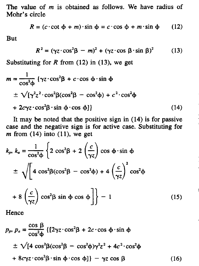

i want to solve below problem
m, ka, pa
i try to solve this problem
but i can't get result.
20230614_lateral earth pressure.sm (100.47 KiB) downloaded 1265 time(s).
Thanks in advance

#2 Posted: 6/14/2023 10:48:20 PM
Hi. Maybe the attached helps, but's hard to know. At the eqn 16 I count two open [ and only one closed ].

#3 Posted: 6/15/2023 7:35:16 AM
My suggested solution is in the attached.

#4 Posted: 6/15/2023 10:55:05 AM
WroteMy suggested solution is in the attached.
Get more accurate solutions from roots(,,,)

#5 Posted: 6/15/2023 11:28:49 PM
Hi. Another way, plugin-less version. Have the advantage that can recognize the active and passive cases.
