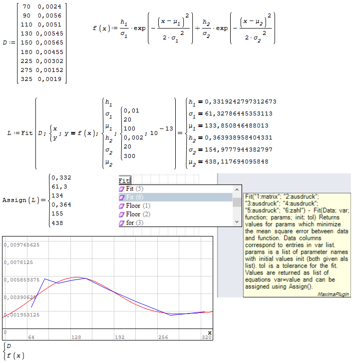

Colleagues.
I have a problem when using it. And I'm not very good at math.
I need to with the sum of three normal distributions.
I have determined the approximating function of 9 parameters, but the iteration of the parameter values to find the minimum of the smallest sum of squares does not go. The program writes that my expression is set incorrectly.
Meaning - Sq(h1,h2, h3, µ1,µ2,µ3,σ1,σ2,σ3)
Could you tell me what I did wrong?

I decided to take a simpler case for now, when we approximate the sum of two distributions.
With some tweaks, the time limit can be circumvented. Although I haven't tried the Fit function yet. Perhaps it will give you a gain in time.
Can you tell me how to limit the accuracy of the calculations? There Sq is calculated with an accuracy of 15 decimal places, while 9 digits are quite enough for me. This would give you a gain in time.
The approximation is quite satisfactory. The defined integral differs from the original value by only 1.5%. Given that the raw data is quite rough, there is actually a histogram, this is quite acceptable.

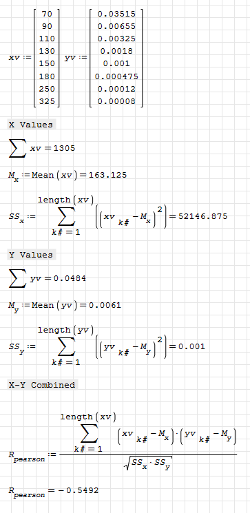

But I still need to calculate the Pearson correlation coefficient, and I'm faced with the fact that the reference book does not specify how to find the sum of the elements of any vector. Can you tell me what you can do in this case?
Regards.
Below you can find how to calculate Pearson correlation coefficient.
To sum all elements of a vector, you can use sum(1).
To operate piecewise you can use sum(4).
You can also use for-loop and while() to calculate something in a vector/matrix. Not demonstrated here.
pearson.sm (8.9 KiB) downloaded 1032 time(s).

There is only one small problem left – is it possible to reduce the accuracy of calculating Sq, respectively Sqmin? As was seen in the calculations, they are calculated with an accuracy of up to 15 decimal places.
And this obviously affects the calculation time. Whereas 9 decimal places, maybe even 8 digits, would be enough for me.
As you rightly pointed out – the calculation time becomes huge.
But I now got out of the situation so that first I manually select an approximate solution (about 5-10 minutes). Then I set the iteration iteration step to 2 or 3 with a wide limit.
The calculation takes 40 minutes. After setting the iteration step to 1, simultaneously reducing the range of values. The calculation takes about 10 minutes.
Thus, the required accuracy is obtained – especially since the integration after the calculation confirms the accuracy of the calculation.
I'll also calculate the Pearson coefficient – in general, it will be fine, you can't ask for anything better. For one set of source data, it takes about 1 hour.
If we have to count three normal distributions instead of two, the time will increase, of course, but I think it will remain within reasonable limits.
Although, if it were possible to reduce the accuracy of the calculations, the calculation would become even easier.
Regards.

There are 3 Pearson coefficients.
From there, up you go.
Thanks
Your solution record is certainly more compact.
However, it will be more difficult for me to modify it for my other cases compared to the Overlord entry.
Regards.
