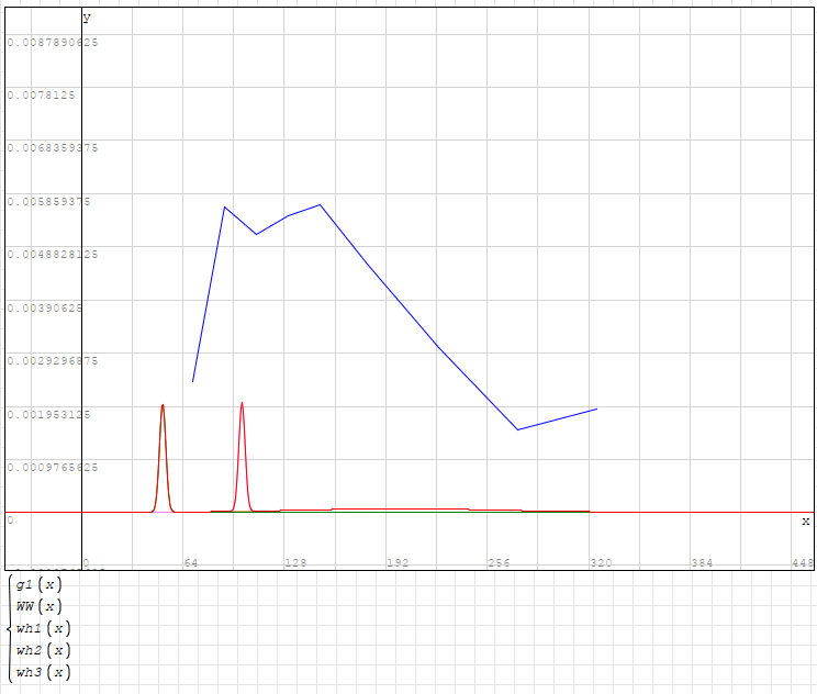

Colleagues.
I have a problem when using it. And I'm not very good at math.
I need to with the sum of three normal distributions.
I have determined the approximating function of 9 parameters, but the iteration of the parameter values to find the minimum of the smallest sum of squares does not go. The program writes that my expression is set incorrectly.
Meaning - Sq(h1,h2, h3, µ1,µ2,µ3,σ1,σ2,σ3)
Could you tell me what I did wrong?
Solution file (01.sm) I attach - 01.sm (31.57 KiB) downloaded 1150 time(s)..
P.S. I'm sorry, I don't speak English very well

There, for some reason, the search of options stopped at the value of hh1 = 0.01, respectively, and hh2 = 001, hh3 = 0.01. That is, h1, h2, and h3 were only checked when the value =1.
Whereas I expected that the iteration of options should reach hh1 = hh2 = hh3 = 1, respectively h1 = h2 = h3 = 100.
For other parameters, it also seems that the search for options has not reached the end.
That is why the resulting graph shows a complete mismatch between the original data and the approximating formula.
I don't have an error in the If statement?
There I put continue in the else field.
eng-min.sm (32.5 KiB) downloaded 1150 time(s).

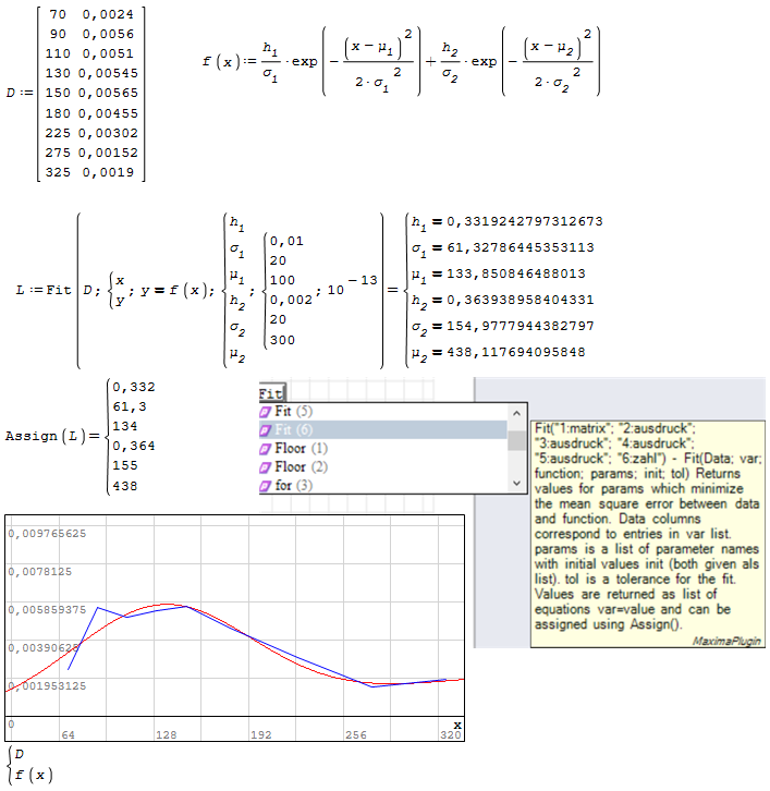

#9 Posted: 6/9/2021 11:10:39 AM
1,139 likes in 1,805 posts.
Hi. Some notes attached.
eng-min.sm (44.48 KiB) downloaded 1176 time(s).
eng-min.pdf (382.41 KiB) downloaded 818 time(s).

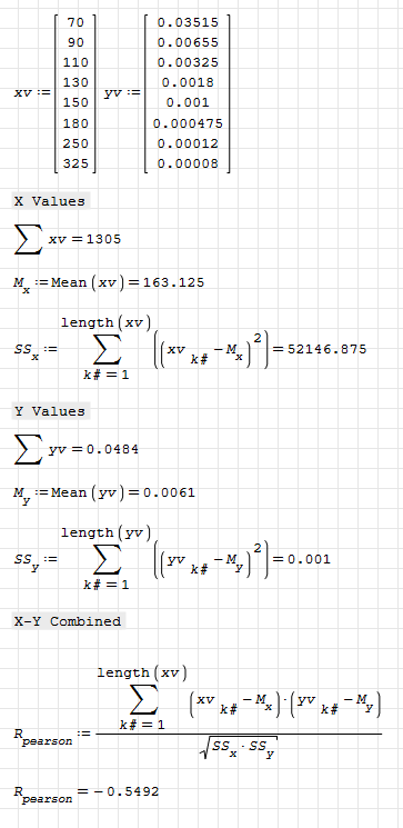

But I still need to calculate the Pearson correlation coefficient, and I'm faced with the fact that the reference book does not specify how to find the sum of the elements of any vector. Can you tell me what you can do in this case?
Pirson-0.sm (14.55 KiB) downloaded 1192 time(s).
Regards.
#14 Posted: 6/13/2021 8:19:06 PM
600 likes in 1,381 posts.
Regards.
Below you can find how to calculate Pearson correlation coefficient.
To sum all elements of a vector, you can use sum(1).
To operate piecewise you can use sum(4).
You can also use for-loop and while() to calculate something in a vector/matrix. Not demonstrated here.
pearson.sm (8.9 KiB) downloaded 1201 time(s).

Dear Martin Kraska
I tried to compose the solution as you suggested.
But for some reason, the program gives an error.
In addition, I have a question – you suggested a solution when the approximation is based on the sum of two normal distributions.
And in my source data, this does not always happen. It is often necessary to look for an approximation by the sum of the three distributions.
Will this increase the calculation time to inconvenient values?
Fit-1.sm (10.39 KiB) downloaded 1139 time(s).
Regards.
