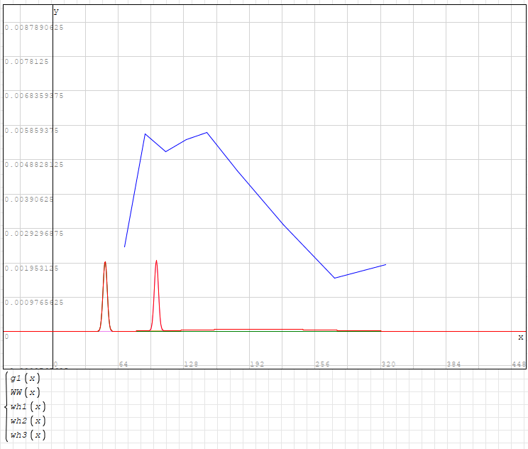

Colleagues.
I have a problem when using it. And I'm not very good at math.
I need to with the sum of three normal distributions.
I have determined the approximating function of 9 parameters, but the iteration of the parameter values to find the minimum of the smallest sum of squares does not go. The program writes that my expression is set incorrectly.
Meaning - Sq(h1,h2, h3, µ1,µ2,µ3,σ1,σ2,σ3)
Could you tell me what I did wrong?
Solution file (01.sm) I attach - 01.sm (31,57 КиБ) скачан 1150 раз(а)..
P.S. I'm sorry, I don't speak English very well

I guess you are trying to multiply matrix elements with itselfs by squaring it.
You can't do that mathematically, unless you vectorize it.
Here is your revised file.
01_rev.sm (30,82 КиБ) скачан 1205 раз(а).

Dear alles,
Thank you for correcting my mistake.
But the desired result still did not work.
There, for some reason, the search of options stopped at the value of hh1 = 0.01, respectively, and hh2 = 001, hh3 = 0.01. That is, h1, h2, and h3 were only checked when the value =1.
Whereas I expected that the iteration of options should reach hh1 = hh2 = hh3 = 1, respectively h1 = h2 = h3 = 100.
For other parameters, it also seems that the search for options has not reached the end.
That is why the resulting graph shows a complete mismatch between the original data and the approximating formula.
I don't have an error in the If statement?
There I put continue in the else field.
eng-min.sm (32,5 КиБ) скачан 1150 раз(а).

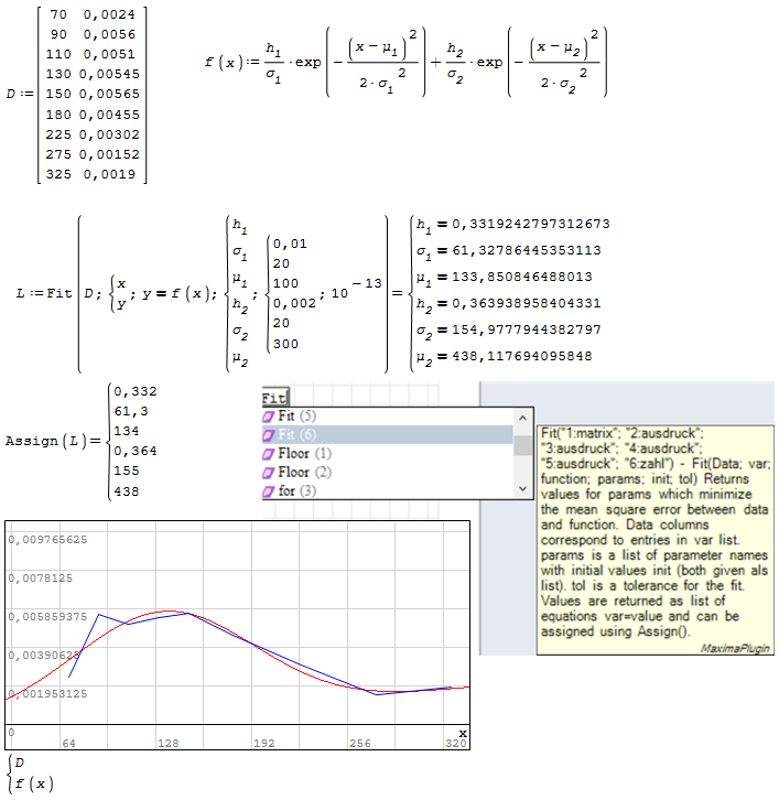

fit.sm (136,38 КиБ) скачан 1168 раз(а).

Hi. Some notes attached.
eng-min.sm (44,48 КиБ) скачан 1176 раз(а).
eng-min.pdf (382,41 КиБ) скачан 818 раз(а).

With some tweaks, the time limit can be circumvented. Although I haven't tried the Fit function yet. Perhaps it will give you a gain in time.
Can you tell me how to limit the accuracy of the calculations? There Sq is calculated with an accuracy of 15 decimal places, while 9 digits are quite enough for me. This would give you a gain in time.
The approximation is quite satisfactory. The defined integral differs from the original value by only 1.5%. Given that the raw data is quite rough, there is actually a histogram, this is quite acceptable.

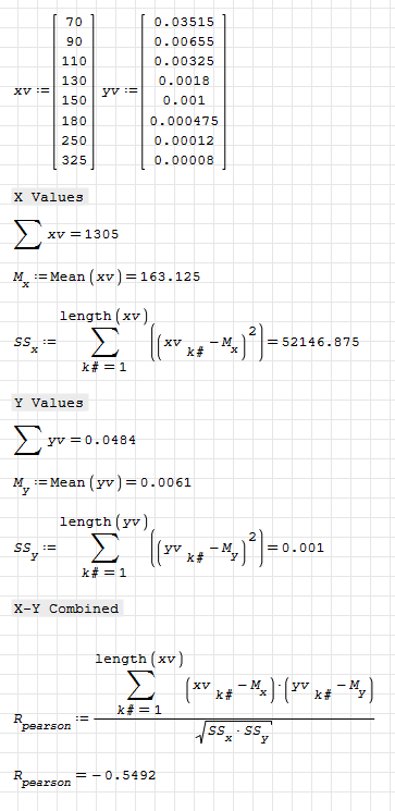

#14 Опубликовано: 13.06.2021 20:19:06
But I still need to calculate the Pearson correlation coefficient, and I'm faced with the fact that the reference book does not specify how to find the sum of the elements of any vector. Can you tell me what you can do in this case?
Regards.
Below you can find how to calculate Pearson correlation coefficient.
To sum all elements of a vector, you can use sum(1).
To operate piecewise you can use sum(4).
You can also use for-loop and while() to calculate something in a vector/matrix. Not demonstrated here.
pearson.sm (8,9 КиБ) скачан 1201 раз(а).
