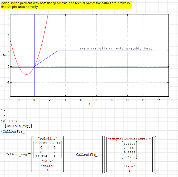

I am going ahead in the Callout project but I have reached a critical point and I am struggling hard ..but do not find a possibility to progress and complete it as I would like.
I was able to create the callout drawing, to word wrap the text in different rows and to convert the rows in BMP strings and to store them in a vertical array ( Alvaro I didn't create a block with all these rows merged togheter as in your program I decided to keep them split ) .

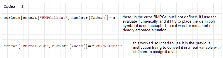

Now i need to apply the instructions to draw them in the XY Plot Region ...and here comes the troubles.
I am not able to create a loop to do this because in this type of instruction :
the image file/name ( i.e. "image:{BMPxCallout1}" )can't be retrived from an array of images and I can't write directly "el(TxtxCallout,i_rows)" , (sorry but I don't know how to write the corresponding indexed variable in this post so I left the internal representation ) but I need to transit through the assigment of that element to a variable not indexed.
I am running through the posts related to creating traces in a loop from Oscar and Martin ..but I am not able to cume up with a solution/workaround .
Any suggestion will be highly appreciated; thanks in advance for any help, take care and best regards.
Franco

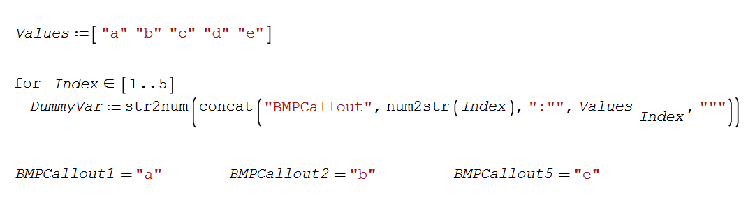

... to create a variable name (continuouly changing with an index) on the left side of an assignment expression and assign to it the content of an indexed variable...
Franco

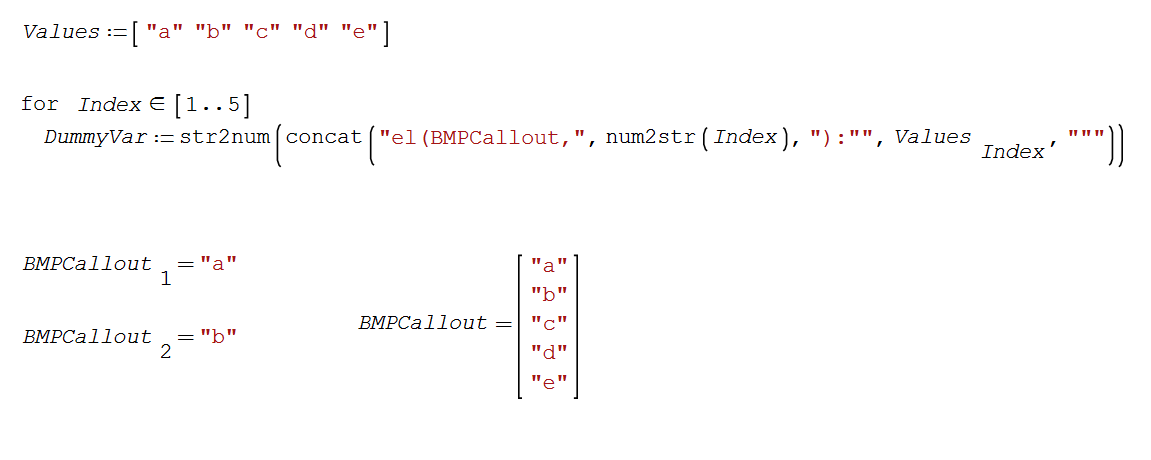

Hi Franco, for assign values to indexed variables you need to use the function el(VECTOR,INDEX) which references an element of a VECTOR by its INDEX. Further steps is management of strings to num and viceversa:
in This Way you will have a Vector called BMPCallout with many indexes as you want and each element has assigned a value.
Another way is to create individual variables ( BMPCallout1, BMPCallout2, ... ) in this way:
on each case, the DummyVar is neccessary to evaluate the conversions between strings and numbers
Best,
Oscar

Oscar ,
thanks a lot - as usually - for the examples and the clarity of the explanation.

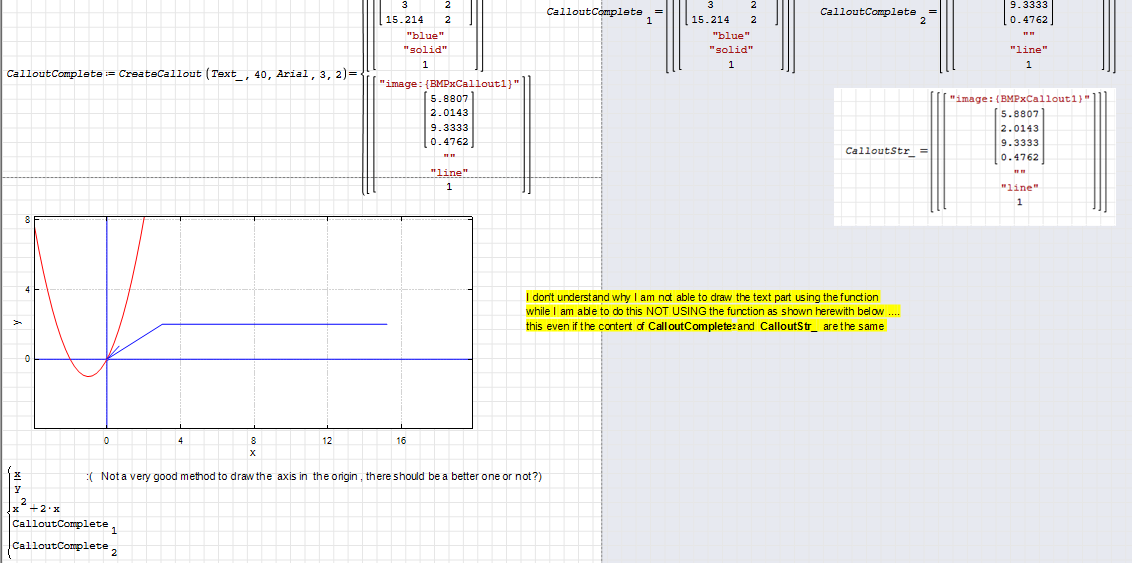

are many weeks that I am going ahead to complete the Callout project , I was able to position correctly the text on both type of Callout I am working on for now ; the one where I place directly the text above and/or below the Callout orizontal line and the other one where the text is enclosed in a rectangle drawn at the end of the Callout orizontal line.
I have placed some limits to te drawing possibilities (i.e. the maximum number of the callout text rows is 8 now).
The only problem that I am struggling to resolve since many weeks is that I am not able to pack all the functions that I have developed in a final container function that i have called CreateCallout.
The only thing I am sure about is that it must be a very stupid thing that I am missing but have done all the possible attempt to understand without succeeding and I have lost mental clarity for further investigation ( I have read several time the document from Davide too , that is really super-detailed about user defined functions ).
Please can you give a look -when you have time- to the attached worksheet to see were I am wrong ?
Thanks in advance for your help, best regards
Franco

Hi Franco. I guess that the problem is that the image tag {img} must be at the worksheet level. Please check the note at the right margin in the file from this post: https://en.smath.com/forum/yaf_postsm86128_X-Y-Plot-Region.aspx#post86128
Images are matrices. You can unlink them from the file showing the matrices with an evaluation, x = ..., expanding the view to the entire matrix, and making a further assignation with x : ... with the most valuable code in windows: copy and paste.

Finally I have a time to check your file and here are the answers and solutions to your questions.
In the attached file...
1. I explain how to obtain the "Arial Matrix" using the magical recipe "copy and paste" :d
2. How to deal with local variable defined inside a function and pass it to the "worksheet level" (as mention Alvaro)
All my answers and commentaries are in yellow font and black background

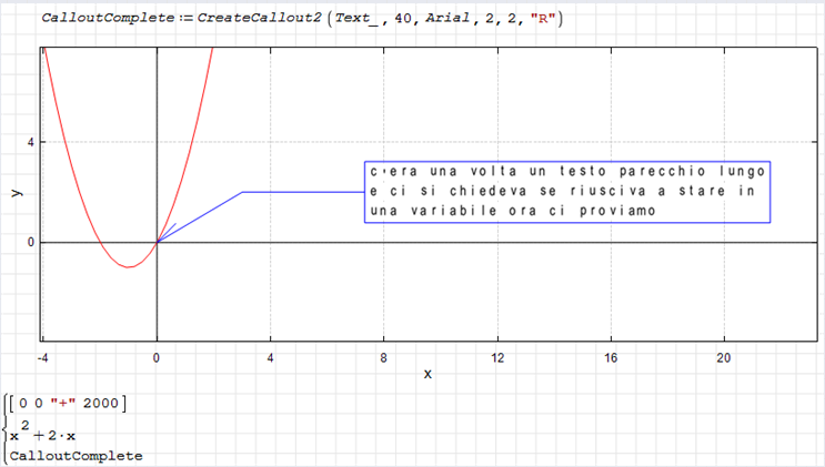

have attached herewith a new release of the create callout functions where I tried to add the features described in my previous post, so:

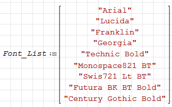

0-Add the trasparency effect to the text placed on the XY area using the Alvaro's method (which I call "Ink jet" method). This is a very interesting and intelligent technique in which only non-white pixels are displayed but applying it to a long text string has been proven to be unfeasible because the worksheet execution times increase too much.
1-Add more fonts from the Alvaro's file and some additional ones with a "Technic" style.It is now possible to select a font from the 9 ones listed herewith.
the files (.png) with each font data are zipped here FontsDataFile.zip (44,94 КиБ) скачан 627 раз(а). and each font can be selected in the worksheet in this way

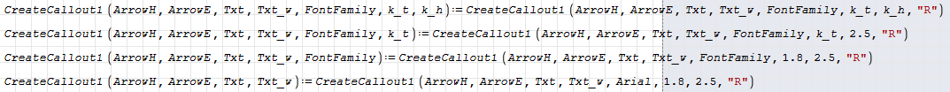

3-Moreover I would like to minimize the Inputs for the creation of a callot using the method seen in some examples from UNI related to Shapes drawing ( basically defining in this way a set of default arguments that can optimize the graphical look of the callout itself and speedup its creation ). Done
For what concern this last point I have the following question. Is it possible in a user defined function that has for instance 7 arguments ( see herewith what I have done for the CreateCallout function in the worksheet attached )
define a default in a central position but NOT beeing obliged to accept already all the defaults related to the arguments at its right ??
I mean if I wonna define that the default just for the argument FontFamily is Arial and for all the other arguments at its right I am free to place whatever I want; how can I write the expression of the user function ?
Or this is not possible to accomplish and simply I must define in the function body at the beginning (usually) that if the argument of FontFamily is "-" or something else that I have pre-defined in advance and that means a default value for the argument in that position I will consider Arial as the FontFamily passed value . Hope that I was able to explain this issue quite well .

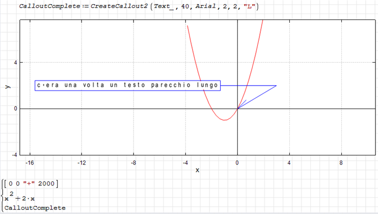

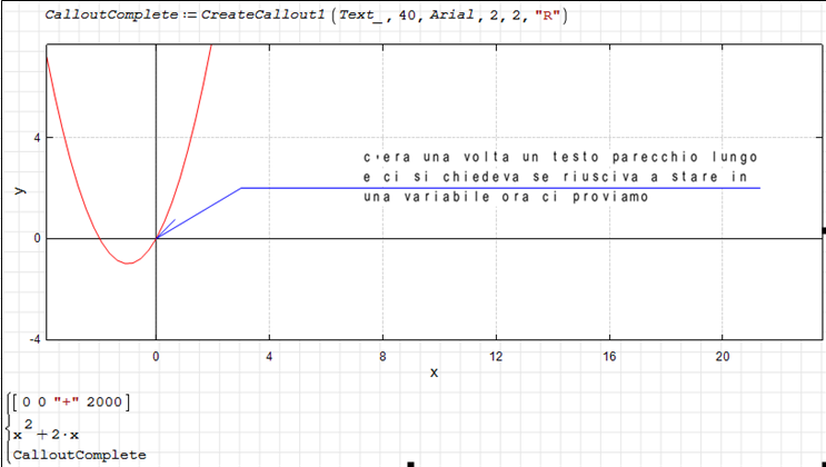

P.S. Herewith some usage examples, they aren't done with the last release of the worksheet, other examples screenshot are in an area at the bottom part of the worksheet
