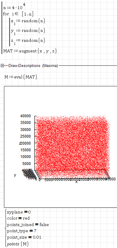

Scatter plots can be made using the Maxima plugin. I didn't respond initially, because the interface has never been tested with 1M points. Yet the backend gnuplot should be able to do that. I just don't know whether there are some limitations in the conversion functions.
The example uses a Maxima Draw3D plot region. You can interactively rotate and resize the plot with the mouse.
Scatter plot_Kr.sm (148,84 КиБ) скачан 2025 раз(а).

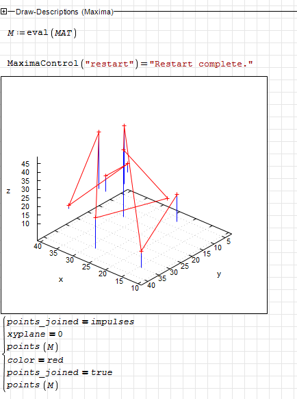

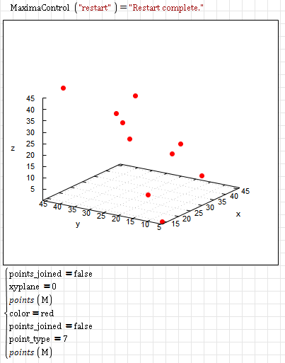

If the plot is sufficiently stable, you can remove the restart command.
You also can remove the first occurances of points_joined and points(). I just used them to demonstrate a selection of options.

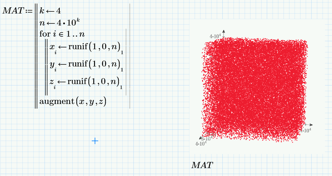

I think that a limit for stability is 40k points. Very difficult to rotate the graphic, but..it is a limit. A normal behavior I will consider until 5k points (to plot in ~5 s and easily rotate).
Again, thank you, because this will help me achieve my program (interaction volume for concrete design). And rarely I will need more than 5k points (I think 1M points was clearly an unthought exaggeration).
Here, the images:
SMath (40k points):
Mathcad(40k points): (plotting limit of Mathcad)
File:
Scatter plot_Kr-1.sm (152,43 КиБ) скачан 1881 раз(а).
Martin Kraska 12.05.2020 04:38:00, frapuano 12.05.2020 07:14:00

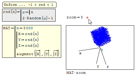

No problem to rotate the graphic ... didn't try 5 k.
All native random in CAS are "uniform"
unless specified [Weibull, Normal, Logistic].
We have those in Smath as utilities.
All modules NUMERIC.

No problem to rotate the 5k graphic
24 Quaternions possible rotations ...
export the preferred angular system.
Would nice to add the cube outline.
Martin: what can you do with that in native SS 6179 ?
Cheers ... Jean.
Rotate 3D TREASURY_4 Quaternions MODULO Matrix.sm (45,96 КиБ) скачан 1874 раз(а).

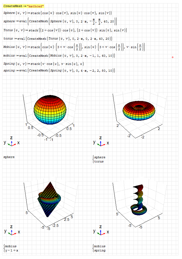

SMath Studio compatibility History page Changes AI Assistant
Plugin updated. [BETA]
It's very difficult to improve this plugin. Basically, I started developing it from scratch.
Changes:
- expression parsing has been improved;
- CreateMesh() function has been improved;
- automatic scaling function has been added;
- surface drawing algorithm has been improved;
- added many bugs.
plot3d-examples-draft.sm (11,38 КиБ) скачан 1419 раз(а).
