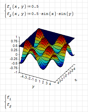

am I wrong or the x and y axis are exchanged?
I have downloaded smath studio a few days ago and made some examples to be more familiar with the program. Today I have tested 3D plot and found 2 strange behaviour.
First on 3D plot x and y seems to be swapped
Second the same formula plotted by 3D plot and by 3D graph give a different view

The SMath built-in 3D plot is left-handed, the 3DPlot Region is right-handed (being able to choose, I prefer the 2nd but is matter of taste)

fdufnews
fdufnews
Thanks for answering.
But the sin function is defined with y as variable and the step function is defined with x as variable. On the 3D plot the sin is along the X axis and the step function along the Y one.

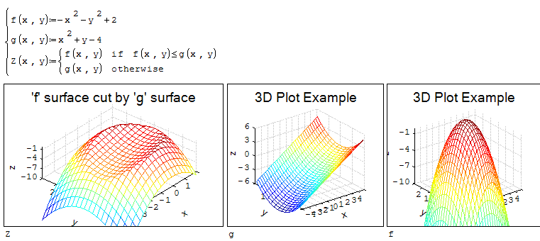

is there a version of a tutorial for dummies for this plugin? I tried to figure it out on my own but can't get it to work.
I just wanted to try and plot a sphere for fun. maybe next would be plot a line / plane and see where it intersects the sphere.
#26 Опубликовано: 18.01.2016 00:26:12
I just wanted to try and plot a sphere for fun.maybe next would be plot a line / plane and see where it intersects the sphere.
______________________________
AFAIK, as far as I have experimented, the Maxima 3d plot is for parametric unctions
and the style in example. It does not plot "volume 3D", it does not take stacked arguments. Up until my help: zap for the sphere and the cutting plane. The 3D Smath default plot is just for fun, nothing to do, no color ... These two may help using this Maxima plot.
Contour X_Y plot.sm (56,37 КиБ) скачан 1711 раз(а).
Contour X_Y plot [More Parametric].sm (103,25 КиБ) скачан 1519 раз(а).

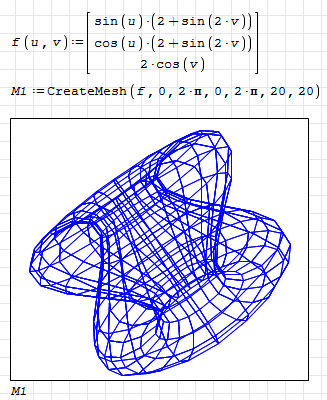

- CreateMesh(): (u,v) can be skipped for the function;

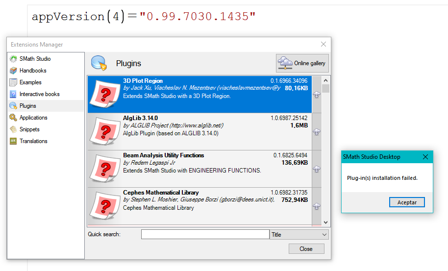

I really need this amazing plug-in to plot around a million independent points, but I am having this issue with the installation. Could someone help me?
Thank you in advance.
Unfortunately, I cannot build a project on the server. We will wait for an answer from the author of the program. As for the plugin itself, it is not yet complete. Displaying data is not intuitive.

Thank you uni and Jean for your answers, now I reviewed my problem. Fortunately I have already installed the 3D Plot Region plugin (99.7030 SM version). I don't know why "plug-in installation failed" last week, but now that problem is solved.

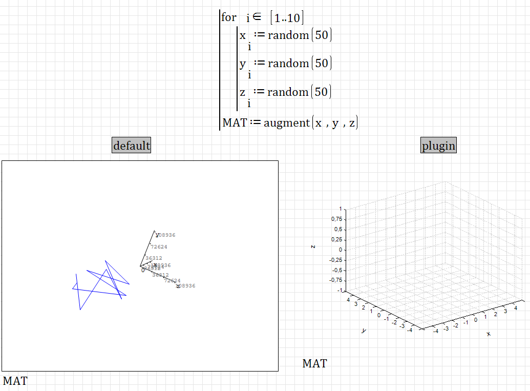

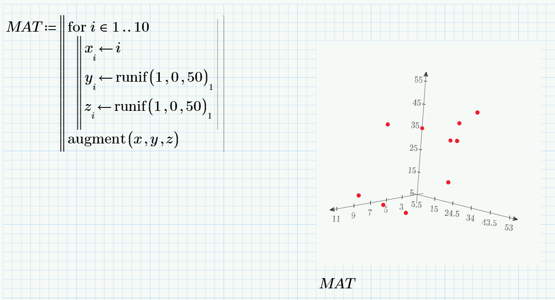

What I understand for the 3D plot region is that you need a function to be plotted, and please correct me if I am wrong. I was reviewing your image creation files Jean, and was very helpful for me to know those functionalities, but in my case, I have a 3D graph more like "scatter plot".
Here, for example, I generate a random matrix 10x3 of ten points in x,y,z coordinates. In the included default 3D plot, it seems that I cannot delete the line between points (I want only the points to be displayed), and also I cannot extend the axis coordinates to verify the coordinates for a point. It looks like the coordinates are reversed, since there is no point plotted in the x+,y+,z+ region (and that region should be the only one with plotted points). Also it seems to be totally out of range because my axis values are around 50000 and I have values no greater than 50.
I hope you can help me, or if you know that I could do this sort of plots in another program but from SMath (I begin to know about Maxima, for instance).
Thank you both again!
SMath:
Mathcad:
SMath file:
Scatter plot.sm (4,54 КиБ) скачан 1626 раз(а).
(sorry for the too large images, I don't know how to change that)

Now this component cannot be fully used for your purposes. Point visualization is not implemented. I am still looking for time to study the theory of three-dimensional graphics. Unfortunately, the limitations do not allow the use of free components. Writing everything from scratch is a time consuming task.

A three-dimensional image can be displayed on a flat graph
https://en.smath.com/forum/yaf_postsm12626_3D-Plot-Region.aspx#post12626
Scatter plotM.sm (13,56 КиБ) скачан 1650 раз(а).
