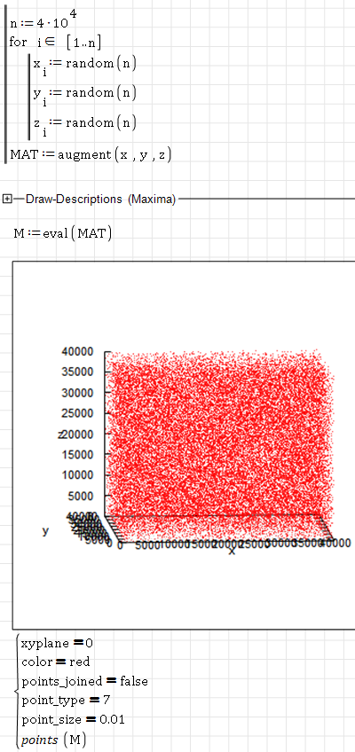

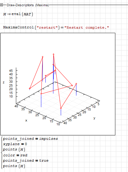

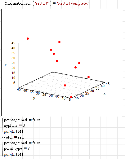

Scatter plots can be made using the Maxima plugin. I didn't respond initially, because the interface has never been tested with 1M points. Yet the backend gnuplot should be able to do that. I just don't know whether there are some limitations in the conversion functions.
The example uses a Maxima Draw3D plot region. You can interactively rotate and resize the plot with the mouse.
Scatter plot_Kr.sm (148.84 KiB) downloaded 1945 time(s).

If the plot is sufficiently stable, you can remove the restart command.
You also can remove the first occurances of points_joined and points(). I just used them to demonstrate a selection of options.

I think that a limit for stability is 40k points. Very difficult to rotate the graphic, but..it is a limit. A normal behavior I will consider until 5k points (to plot in ~5 s and easily rotate).
Again, thank you, because this will help me achieve my program (interaction volume for concrete design). And rarely I will need more than 5k points (I think 1M points was clearly an unthought exaggeration).
Here, the images:

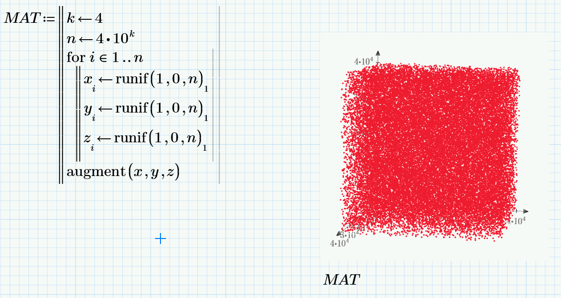

SMath (40k points):
Mathcad(40k points): (plotting limit of Mathcad)
File:
Scatter plot_Kr-1.sm (152.43 KiB) downloaded 1814 time(s).

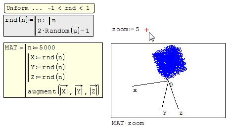

#47 Posted: 5/12/2020 8:45:37 AM
No problem to rotate the 5k graphic
24 Quaternions possible rotations ...
export the preferred angular system.
Would nice to add the cube outline.
Martin: what can you do with that in native SS 6179 ?
Cheers ... Jean.
Rotate 3D TREASURY_4 Quaternions MODULO Matrix.sm (45.96 KiB) downloaded 1807 time(s).

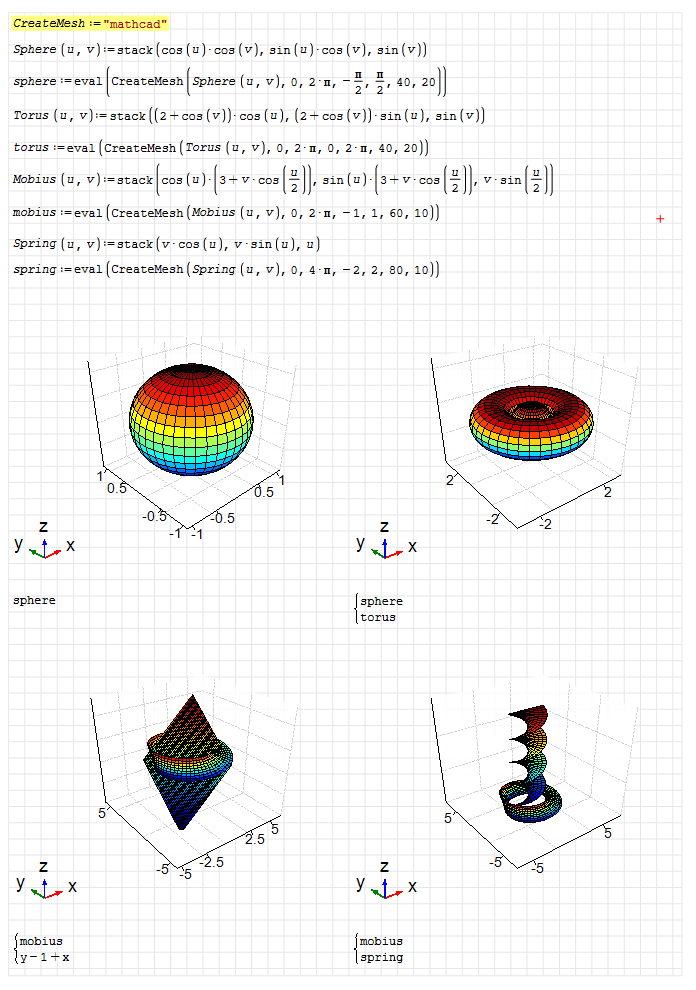

SMath Studio compatibility History page Changes AI Assistant
Plugin updated. [BETA]
It's very difficult to improve this plugin. Basically, I started developing it from scratch.
Changes:
- expression parsing has been improved;
- CreateMesh() function has been improved;
- automatic scaling function has been added;
- surface drawing algorithm has been improved;
- added many bugs.
plot3d-examples-draft.sm (11.38 KiB) downloaded 1349 time(s).

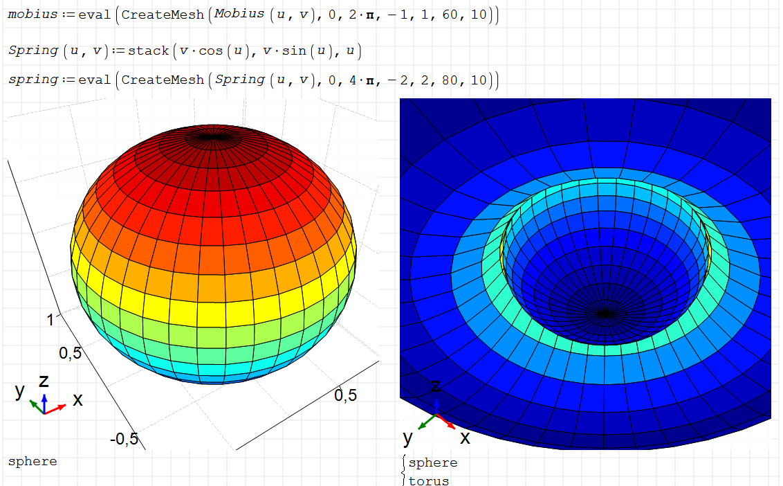

#53 Posted: 8/20/2025 8:37:50 AM
1,555 likes in 1,867 posts.
Changes:
- improved mouse control;
- temporarily disabled autoscaling;
- added anti-aliasing when drawing.
Edited 8/20/2025 8:39:22 AM
