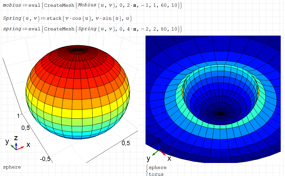

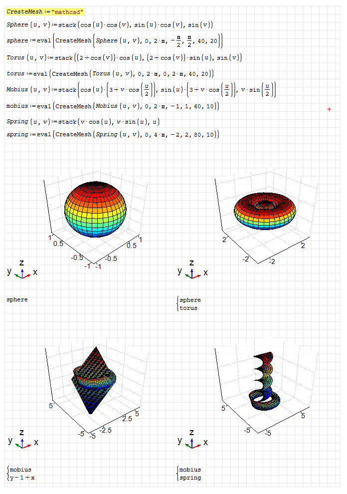

SMath Studio compatibility History page Changes AI Assistant
Plugin updated. [BETA]
It's very difficult to improve this plugin. Basically, I started developing it from scratch.
Changes:
- expression parsing has been improved;
- CreateMesh() function has been improved;
- automatic scaling function has been added;
- surface drawing algorithm has been improved;
- added many bugs.
plot3d-examples-draft.sm (11,38 КиБ) скачан 1393 раз(а).

#53 Опубликовано: 20.08.2025 08:37:50
Changes:
- improved mouse control;
- temporarily disabled autoscaling;
- added anti-aliasing when drawing.
Отредактировано 20.08.2025 08:39:22
