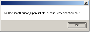

#10 Опубликовано: 18.05.2014 11:45:37
Is the Excel import meant to be Viewer-safe? I get the attached error message if I try to run a viewer application with excel read. With ods-format the situation is similar.
#11 Опубликовано: 18.05.2014 18:12:19
To be honest, I've never tried these plugins in SMath Viewer; seems that the external assemblies are not embedded in the Viewer.
As secondary thing reading the ClosedXML/Ionic.Zip licenses I suppose that any Viewer executable shall contains the relative copyright notice, and this actually is not possible (if this is not made by you manually)...
Martin Kraska 19.05.2014 14:45:00

#14 Опубликовано: 05.08.2014 11:56:26
msiseminger
msiseminger
1 сообщений из 1 понравились пользователям.
Davide,
The issue with "DocumentFormat.OpenXml.dll" not found when you create and run an .exe can be resolved by removing the reference to the .dll from the "References" section in your extention solution. You do not call this .dll anywhere in the extension so it is not needed. When I do this, I no longer get the missing .dll error.
The .exe still does not pull in the Excel spreadsheets I want with the missing .dll error fixed. I did do further investigation and the .exe program can not handle even a simple mat() function by itself with no other references. This lead me to believe that the .exe program is at issue and not your extension.
Mike
Davide Carpi 05.08.2014 14:05:00
