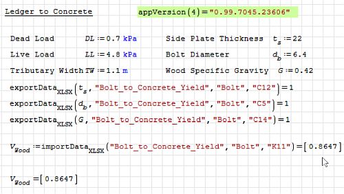

#46 Опубликовано: 18.04.2019 10:08:19
Mo
Mo
0 сообщений из 34 понравились пользователям.
I was using this great plugin and found that sometimes it does weird thing.
for instance, it gave an error and I had to re-write the import/export expression to make it work again.
but now I am stuck with something that I don't understand why it is happening, when I want to read from cell K11 the result is 1.01 instead of 0.86
trying other cells will give correct results except K11 will not return the correct value.
Thanks!!
Another point, in the attached file, I am using both import and export functions, when I update any variable in my SMath sheet, the results in Excel is updated but the results in SMath do not change (the import function does not refresh and if I manually refresh it, still I am stuck with old values), why?
Файл не найден. Файл не найден.
Temp.zip (8,96 КиБ) скачан 625 раз(а).
#47 Опубликовано: 18.04.2019 11:23:30
NDTM Amarasekera
NDTM Amarasekera
It works for me. Close Excel file and Recalculate the SMath file.
SMath displays an error if Excel file is open.

#48 Опубликовано: 18.04.2019 19:21:19
Mo
Mo
It worked when I closed both Excell and Smath and opened SMath again.
but the problem now, is when I change the inputs, say ts=22mm the output (calculated value from excel) does not update, which is essential in a sheet like that.

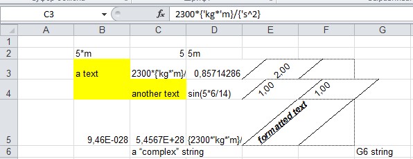

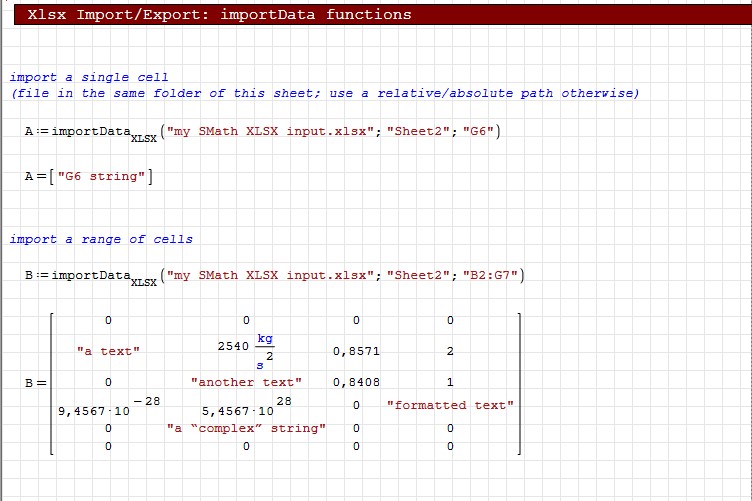

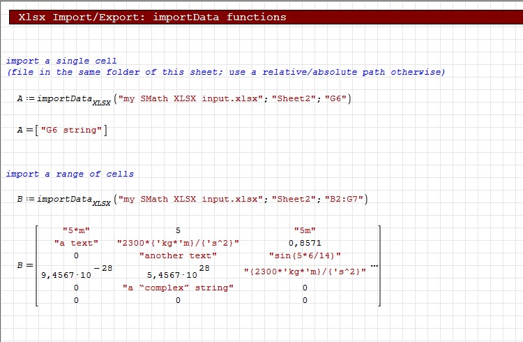

#52 Опубликовано: 21.02.2021 14:25:04
goha
goha
Please help me, if you can.
I have a problem when importing numbers with units of measurement.

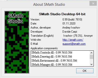

Using SMath Studio Desktop v 0.99 build 7610 with XlsxImportExport 1.3.6996.39330
When I try to import a number with units of measurement from xlsx document, like for example: 2300 * {'kg *' m} / {'s ^ 2} in SMath Studio, I get string variable as a result: "2300 * {' kg * 'm} / {' s ^ 2} ".
How can I get number with units of measurement type variable, like this image1.png
Source document: my SMath XLSX input.xlsx
Example, before recalculation:
Example, after recalculation:
Software versions:
#53 Опубликовано: 21.02.2021 14:35:14
Hi. You can try to apply this algorithm, and see if you are satisfied with its result:
