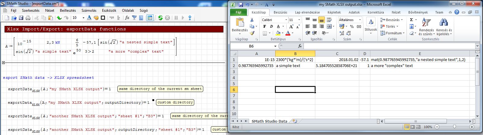

I found a failure with XLSX Import/Export plugin using in our national settings (Hungarian). We use "," as decimal symbol in Excel and in SMath too.
If I export 5/4 or '0,8' to Excel, I'll get '0.8' (string). If I export 6/4, I'll get '2018.01.02' (date).
If I import '="2.54*{'kN/'m}"' from Excel, I'll get '="2.54*{'kN/'m}"' (not '2,54 kN/m').
If I import '="2,54*{'kN/'m}"' from Excel, I'll get '="2,54*{'kN/'m}"'.
But if I import '0,8' (number) from Excel, I'll get '0,8' value (wich is correct).
Peter Kaderasz
Peter Kaderasz
Hello, I'll inspect it ASAP (and if your able to provide a small file with these example it would help too )
#36 Опубликовано: 15.08.2018 03:53:33
kadpeter
kadpeter
0 сообщений из 10 понравились пользователям.
Hello Davide,
I've tried the examples from the plugin's documentation (https://en.smath.info/forum/yaf_postst1860_Xlsx-Import-Export-plugin.aspx).
Here is a picture (this time I modified '4/5' to '6/5', you can see that this value imported to Excel as '2018.01.02' in our date format 'yyyy.mm.dd'):
Показать спойлер
Other numerical values, f.e. '-57,1' and 'sin(2^(1/2)) imported to Excel as string, so we can't do mathematical operations with these values.
Peter Kaderasz

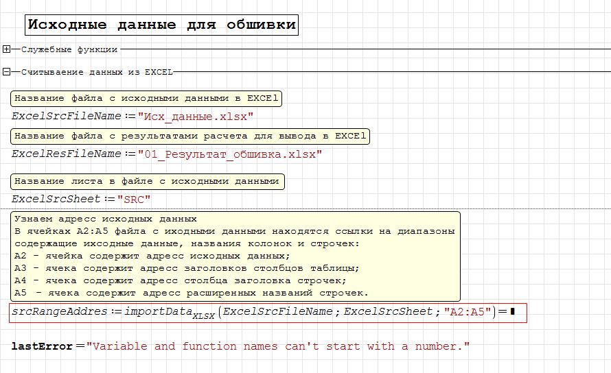

Hello, stopped working import from xlsx file.
lastError = " Variable and function names can't start with a number. File attached
test.sm (7,14 КиБ) скачан 1506 раз(а).
