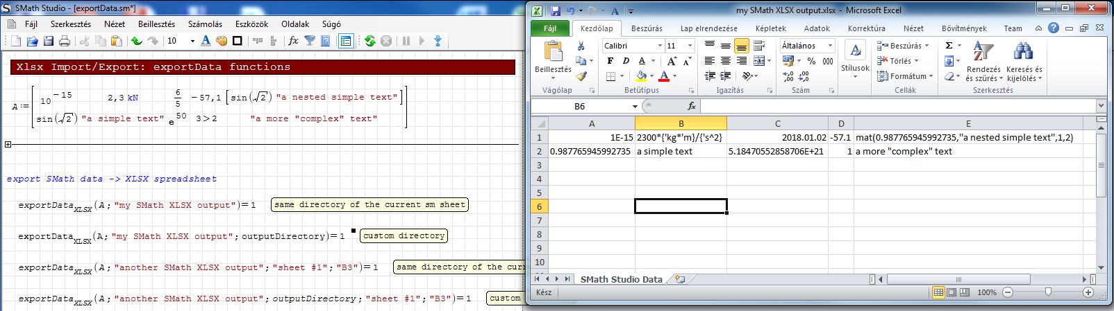

I found a failure with XLSX Import/Export plugin using in our national settings (Hungarian). We use "," as decimal symbol in Excel and in SMath too.
If I export 5/4 or '0,8' to Excel, I'll get '0.8' (string). If I export 6/4, I'll get '2018.01.02' (date).
If I import '="2.54*{'kN/'m}"' from Excel, I'll get '="2.54*{'kN/'m}"' (not '2,54 kN/m').
If I import '="2,54*{'kN/'m}"' from Excel, I'll get '="2,54*{'kN/'m}"'.
But if I import '0,8' (number) from Excel, I'll get '0,8' value (wich is correct).
Peter Kaderasz

#36 Posted: 8/15/2018 3:53:33 AM
kadpeter
kadpeter
0 likes in 10 posts.
Hello Davide,
I've tried the examples from the plugin's documentation (https://en.smath.info/forum/yaf_postst1860_Xlsx-Import-Export-plugin.aspx).
Here is a picture (this time I modified '4/5' to '6/5', you can see that this value imported to Excel as '2018.01.02' in our date format 'yyyy.mm.dd'):
Show Spoiler
Other numerical values, f.e. '-57,1' and 'sin(2^(1/2)) imported to Excel as string, so we can't do mathematical operations with these values.
Peter Kaderasz

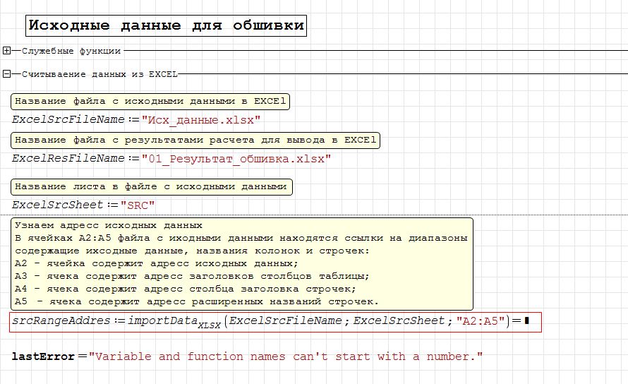

Mikka
Mikka
36 likes in 206 posts.
Hello, stopped working import from xlsx file.
lastError = " Variable and function names can't start with a number. File attached
test.sm (7.14 KiB) downloaded 1506 time(s).
