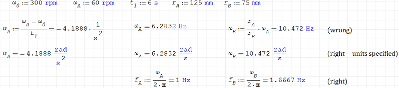

Hi. I'm quite sure this three guys think that rpm in SMath is well defined.
RPM_IN_PRACTICE.sm (562,47 КиБ) скачан 1322 раз(а).

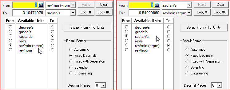

The following is the same calculation as the first example you provided, using the Windows Stable 0.99.7822 version of SMath (output units were not specified, except for the values on the line where it says "units specified" ).
One could specify "rad/s" as the units, and no change would occur, which is fine for the first example that you provided (because SMath assumes that rad/s and 1/s are the exact same unit -- which they are, for angular velocities ONLY -- again, this is because radians are unitless), but it is absolutely incorrect as soon as FREQUENCY is required. SMath treats angular velocity or angular frequency (rad/s) and frequency (Hz or 1/s) as equal, which they aren't.
ω = 2 π f ~~~~ That's: (angular frequency) = 2 * (pi) * (frequency)
If you have a piston attached to disk B, then the frequency of the piston is EQUAL TO the frequency of the disk (NOT the angular frequency). Smath would calculate the frequency to be 10.472 Hz (wrong), when it would actually be 1.667 Hz (right).
This is because of how frequency is defined: it is the reciprocal of period, and period is the time it takes for a measurable event to occur. Frequency is therefore the times per second that the event occurs.
For angular frequency only, the period is the time it takes to rotate through an angle of ONE RADIAN (~57.3°). In other words, seconds per radian. Angular frequency is therefore the times per second that the object rotates by ~57.3°.
For most other applications, the period is the time it takes for a rotating OR oscillating object to pass its starting position. In other words, seconds per revolution or seconds per oscillation (cycle). Frequency is therefore the times per second that a roating or oscillating object passes its starting position.
I don't have time to go through the other examples. I've got homework to do, and I've gotta figure out workarounds to make SMath behave as expected with frequency, since it DOESN'T handle rpm <> Hz conversions properly, as evidenced by the very simple statement below:

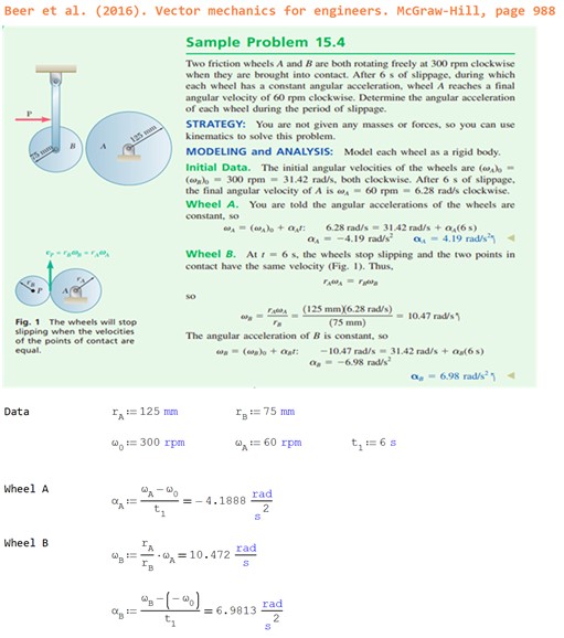

Nope. Your error is here:
1 [rad] = (Circumferential path segment that is the same length as the radius)/(Radius) = [m]/[m] = [unitless]
QED.
I don't specify units, I (and those three guys, if you don't know them, it could be a good read for introduce some basics) specify dimensions, not units. Radians are not unitless, they are an unit, are dimensionless, which isn't the same. For instance, masons, architects and civil engineers often measure the slopes of their angles in buildings in cm / m, quantities that are dimensionless but certainly have units.

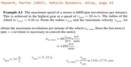

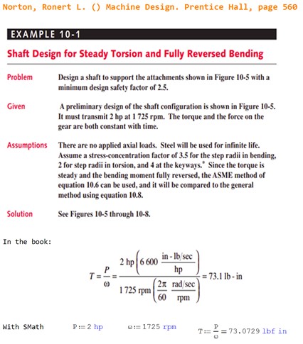

Following your line of reasoning, you should tell Norton to correct his book, as his torque values (lbf-in) are badly wrong because he forgot to include radians. Or you don't measeure torques in energy units? Because I do. And Norton too.

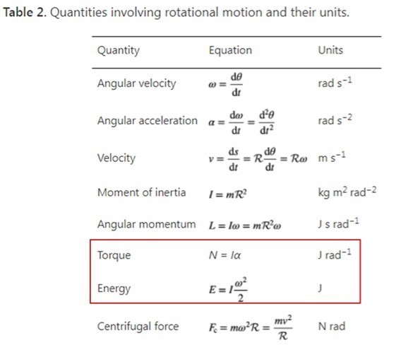

This paper sums up my meaning: Dimensionless units in the SI
From your paper, here is the problem:
As I say before, all books are wrong with that convention. This is: Torque must to have radians. Can you imagine calculating a Lagrangian, or worse, an action integral, with those units?
I fail to see how that is relevant.
I'm not suggesting that torque shouldn't use radians.
I'm merely suggesting that the use of radians in frequency should be *explicit* in SMath (i.e. that frequency in Hz should be assumed as cycles/s, not rad/s), to conform more to how most calculations are commonly performed on paper. OR that SMath should come up with a way to allow the user to select the behavior in this case. (For example, perhaps a "rigid standards" mode vs "common usage" mode.)
As an example, motor power is not calculated from RPM without first converting to rad/s, and most industrial motors rotate at a fixed ratio w.r.t. the electrical supply frequency (i.e. ω = A * 2π * f), where A is the ratio, and f is the supply frequency. Having to use workarounds and double-check that the output units are functioning as expected every time can become rather cumbersome. In my case, it's sufficiently bothersome that using SMath (which is typically my go-to for this type of assignment) could unnecessarily complicate my combinations this time around.
