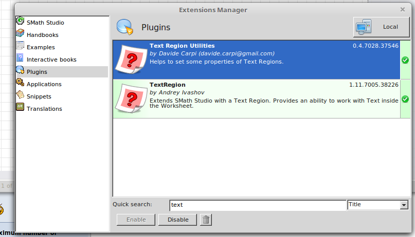

1 441 сообщений из 2 932 понравились пользователям.
I don't know what is going on, because, the "standard ToolboxButtons" addin is there, and enabled, but it does not come in on the pulldown menu under insert.
"Standard Toolbox Buttons" is the built-in plugin that handles the callapsible palettes on the right of the screen (Arithmetic, Matrices, Booleans, etc...)
Text region Utilities is a different addin and provides (even) the "toolbox region".
If you search "text" in your extensions manager and you have the plugin installed you should see something like this (SS 0.99.7005):
#17 Опубликовано: 17.04.2019 12:45:05
The Cross
The Cross
0 сообщений из 73 понравились пользователям.
I have Text Region Utilities now. Is there a way to use search and replace to just search a selected portion of the worksheet, and not search the whole worksheet? Can I select a certain portion of the worksheet and have SMath search and replace for just the selected area?
