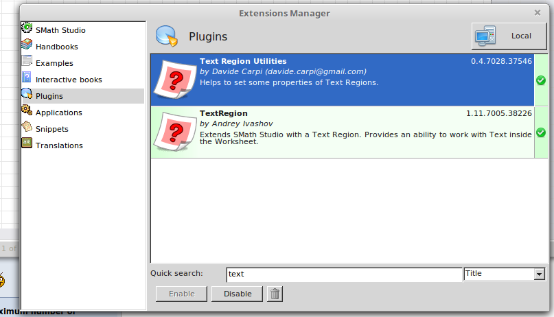

#16 Posted: 4/9/2019 6:35:10 PM
1,440 likes in 2,928 posts.
I don't know what is going on, because, the "standard ToolboxButtons" addin is there, and enabled, but it does not come in on the pulldown menu under insert.
"Standard Toolbox Buttons" is the built-in plugin that handles the callapsible palettes on the right of the screen (Arithmetic, Matrices, Booleans, etc...)
Text region Utilities is a different addin and provides (even) the "toolbox region".
If you search "text" in your extensions manager and you have the plugin installed you should see something like this (SS 0.99.7005):
