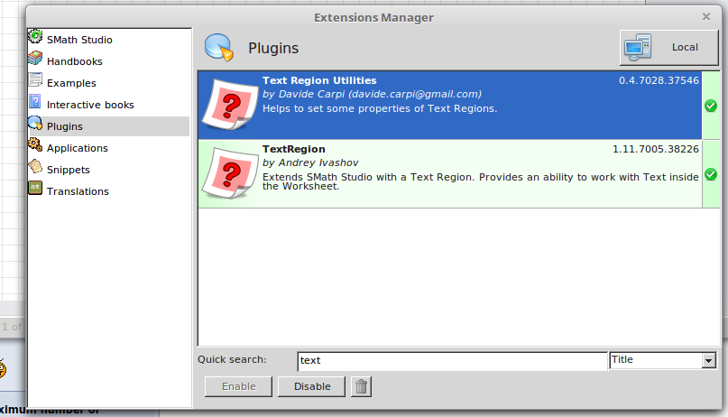

If you search "text" in your extensions manager and you have the plugin installed you should see something like this (SS 0.99.7005):
