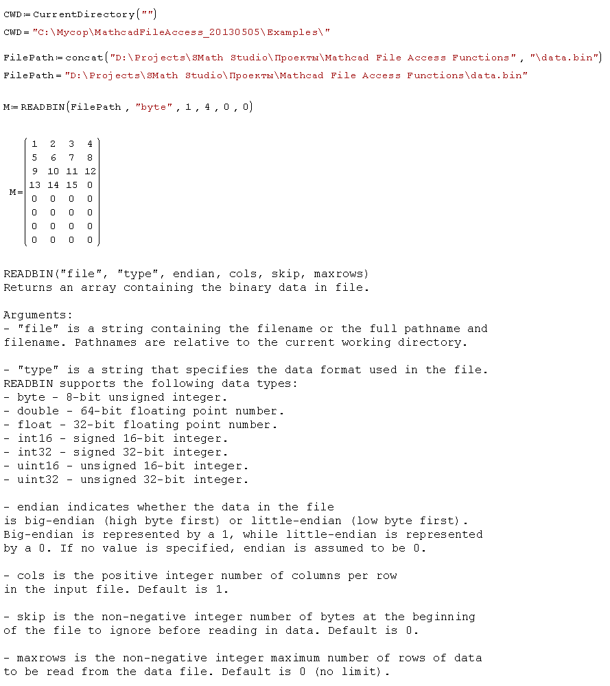

In READBIN(), the last argument specifies the number of lines to read. If set to zero, in Mathcad you get as many lines as the file can give, in SMath you get an empty matrix (good for stacking loop init, as I learned yesterday). If I specify more lines than the file can provide, then in Mathcad the result is augmented by zeros, in SMath I get as many lines as the file can give.
Thus, is the intent to provide a very big number of lines if I do not know the size of the file in advance?
Martin
#4 Опубликовано: 04.05.2013 12:10:28
Ok, I'll try to fix the functions and add a description (you can find it in the Mathcad Help).

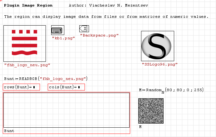

- READBIN: in some situations, changes in the sheet trigger the results to become wrong. Manual re-calculation via toolbar button sets the results back to correct values, but otherwise they persist on the sheet. I attach two screenshots, the upper before re-calculation and the lower after. No other difference between these pictures, just pressed the update button. The sm-sheet is included in the zip. The problem is completely reproducible with the given example.
- READBIN: The docs refer to default values for endian, rows, skip and rows. How is the user expected to adress these defaults? Do you plan to provide READBIN(1) as in Mathcad? What would then be the default type?

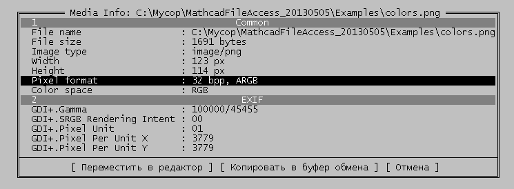

- READ_xxx: These functions seem to insist on 32bpp images, at least, the one in the attached zip fails to be read in. It is a screenshot, which I intended to use instead of the not so colorful school logo.
The image region is not so picky about that, the image can be displayed without problems. However, if a read statement fails and then the result of that failed op is fed to the image, SMath crashes.
MathcadFileAccess_problems.zip (3,27 КиБ) скачан 561 раз(а).
#7 Опубликовано: 04.05.2013 17:44:51
Try to update ImageRegion plugin. As for the images. Only two formats are supported for now: 24bppRGB and 32bppRGB (without alpha channel). Your image has an alpha channel (transparency).
That I don't understand. It seems that reading is the same file, but with a different content. Below is running another writing function and it can change the data. Try to disable or enable the calculation for one of them (WRITEBIN). It is better to use a different file for testing in one sheet.
I forgot to remove it when copying, but it is possible to have a simplified version of the function.

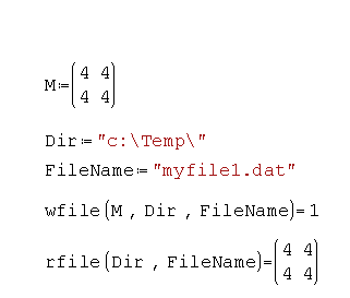

Updated. wfile(3) and rfile(2) added.

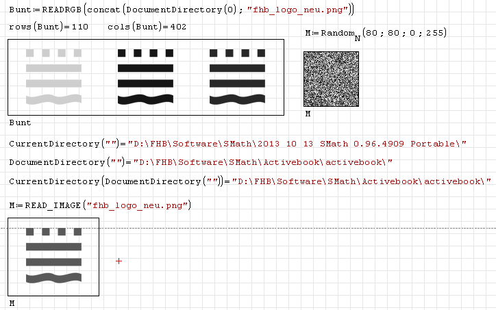

I propose the same changes like here in order to make relative path names relative to the directory of the currently open document instead of the current directory of the system. Thus you could make portable arrangements of data and SMath documents.
Edit: I'd like to also ask for a function DocumentDirectory() which returns the path name of the currently open document. Thus we could benefit from the same improvements with built-in functions like importData.
#14 Опубликовано: 14.10.2013 16:23:59
Updated. DocumentDirectory() added. Try now.
Martin Kraska 14.10.2013 16:35:00
#15 Опубликовано: 14.10.2013 16:44:44
Simply great! Thanks uni. This gives two options: either you build the path for file access ops using concat or you set the current directory to the document directory. This relieves the need for the changes in the access functions, now IMHO having priority "nice to have".
