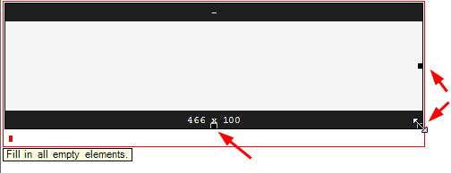

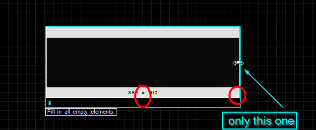

#7 Опубликовано: 18.09.2013 16:19:08

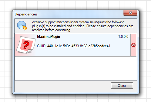

Davide, look at the first picture please - there is only one placeholder at the right side for resizing. I con not find the placeholder on tho bottom or at the right corner.
Martin, look at the second picture please. Where is this comming from . I just opened the file you attached to the previous post and this message box appeared. Is there any Maxima plugin in the development and not available at the moment?
#8 Опубликовано: 18.09.2013 17:16:15
Sorry for the confusion. LinSolve(2) is from Maxima, I forgot to switch that back to the snippet version LinSolve(1). Just remove the second argument, then the file should run.
No, there are 3 placeholders, you can't see them because the background is close to black. From my smartphone and from my notebook (with sloping LCD) I can see both the bottom placeholders... don't worry, I'll make something - BTW if you move the pointer over the bottom-left corner or over the half width of the bottom edge the mouse cursor will change.

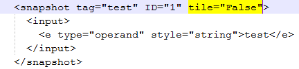

- can export the canvas tile (off by default).
* if you need to update sheets where there are Snaphot Regions, add inside the worksheet code the attribute
tile="False"

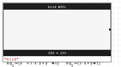

Currently, the snapshot region is fine, if you have dedicated SMath documents for generating these snapshots. However, if you want to use these documents as parts of the help system (e.g. Activebook) then the current region formatting is a little distracting. Would it be possible to hav an (optional) less dominantly structuring design, lets say like proposed in this post?
#17 Опубликовано: 22.09.2013 17:18:14
AFAIK a real frame (with empty body) is not possible with custom regions, but I may be wrong;
To let the region easily editable I can add a control to collapse the region in a smaller one; BTW this don't let you know what's the exported region, so if something change requiring more width or height you need to expand again the region before resizing it...
