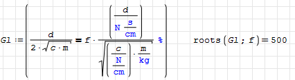

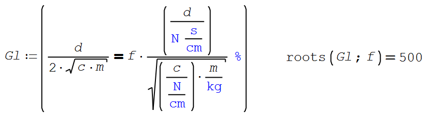

I observed that the clipboard copy of SMath region provides a high resolution bitmap. This seems to correspond to the screen resolution at zoom level 200%.
whereas the snapshot region provides the following:
Is that what I can expect from Snapshot region or should that be better and I am just doing something wrong?
Is there any chance to get something like the snapshot region (even without the option to clip regions) in the clipboard resolution? Any experience with playing around with system dpi settings, Windows scaling factor and the like?
