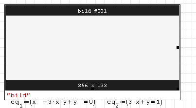

- Area regions must be expanded, otherwise the snapshot contents is shifted by the amount of hidden vertical space.
I don't understand or I can't replicate the issue (see the attchment)

In the example, the snippet region is collapsed, the contents of the exported file is from somewhere below the snapshot region.
example support reactions linear system.sm (34.15 KiB) downloaded 2142 time(s).

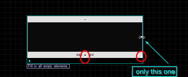

Davide, look at the first picture please - there is only one placeholder at the right side for resizing. I con not find the placeholder on tho bottom or at the right corner.

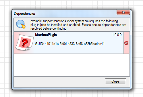

Martin, look at the second picture please. Where is this comming from . I just opened the file you attached to the previous post and this message box appeared. Is there any Maxima plugin in the development and not available at the moment?
Sorry for the confusion. LinSolve(2) is from Maxima, I forgot to switch that back to the snippet version LinSolve(1). Just remove the second argument, then the file should run.
The plugin is going to go public soon. One of our students is doing a great job with the coding work, I am doing the specification/docs and the testing. We just want to have the user interface (functions) to settle a bit. You find some doc preview in the SVN activebook. You can use the waiting time to install Maxima (plugin developed and tested under win only).
No, there are 3 placeholders, you can't see them because the background is close to black. From my smartphone and from my notebook (with sloping LCD) I can see both the bottom placeholders... don't worry, I'll make something - BTW if you move the pointer over the bottom-left corner or over the half width of the bottom edge the mouse cursor will change.
Thank you, that's my lack

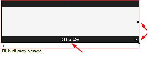

I suppose you figured out how to use Greenshot and to see the resize arrow because you deleted the question in your previous post (You are right, I am using it as well). Just in the Preferences set to see the mouse and increase the the time delay in order to have enough time to change the mouse appereance.
Thank you Radovan, that's exactly what I need
My first rude solution was to press "more resolutely " the stamp key, I've missed that setting

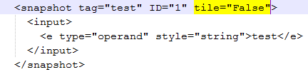

- can export the canvas tile (off by default).
* if you need to update sheets where there are Snaphot Regions, add inside the worksheet code the attribute
tile="False"
