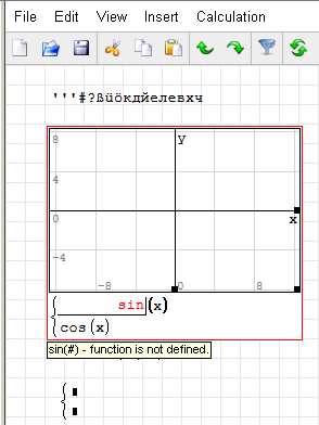

Currently I'm working to replace existing SMath Studio Live with Cloud version of SMath Studio.
Here is it: http://smath.info/cloud (based on the latest SMath Studio version).
It supports the following Regions: Math, Text, Graph, Picture, Area, Modeller, Checkbox, Combobox. Undo/Redo feature is fully implemented. Clipboard, ability to select parts of the regions or move Graphs and work with Shapes of Modeller. It became faster and stable.
Work on this new version is in progress, so top menu and toolbars will be available later, but you can use well-known shortcuts (Ctrl+Z, Ctrl+Y, Ctrl+C, Ctrl+V, Ctrl+X, ", @, etc) to work with this tool. Try it!

Great work!
I experience input problems with german keyboard:
- cannot input units (' character does not work)
- I have to input a right (closing) paren in order to get a pair of them.
These problems also appear in smath live and in Knovel interactive equations.
Edit: Rainbow game: Modeler region does not accept input (no mouse response). Moving the modeler region makes it jump to top of the sheet, there seems to be an issue with area regions, if I open the first one, the modeler region jumps inside it and cannot be moved any more.
Edit: F5 just inserts the letter t, the other function buttons are mapped to other regions, F12 creates an empty placeholder.

Main menu and top toolbar are implemented. Links for server version of SMath Studio changed from Live to Cloud.
Another great improvement: no lost symbols on typing anymore!
Further improvements coming soon.
