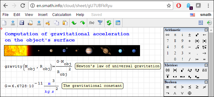

In English:
In Russian:

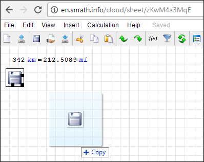

Drag'n'drop of Worksheets and image files implemented (Worksheets are opened in the separate tab, while images will be added directly at the cursor location).

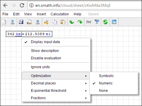

Context menu is now supported for focused Regions.

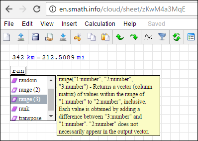

Dynamic assistance is implemented for all applicable Regions (it is also localized based on the selected language).

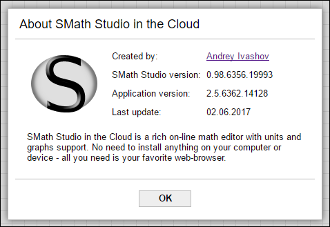

About dialog contains date of the last update and version of the SMath Studio Core used on server-side (it will always correspond to the latest available SMath Studio version if nothing critical is found there).
