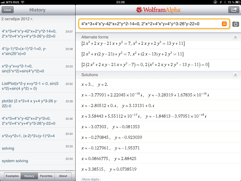

Example 1. Finding extremes: Himmelblau's function:
[MATH]f(x;y) : (x^2+y-11)^2+(x+y^2-7)^2[/MATH]
[MATH]sys(4*x^3+4*x*y-42*x+2*y^2-14=0;2*x^2+4*x*y+4*y^3-26*y-22=0;2;1)[/MATH]
P. S. Buchberger's algorithm can solve systems like that much easer.
Radovan Omorjan 02.10.2012 07:51:00, Davide Carpi 02.10.2012 10:16:00

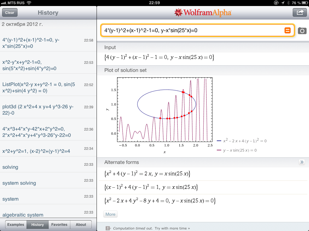

#3 Опубликовано: 02.10.2012 10:43:03
Example 3. Finding roots: System 2.
[MATH]sys(4*(y-1)^2+(x-1)^2-1=0;y-x*sin(25*x)=0;2;1)[/MATH]
Radovan Omorjan 02.10.2012 11:25:00, Davide Carpi 02.10.2012 11:40:00

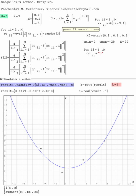

#9 Опубликовано: 04.10.2012 06:47:37
Radovan, I think this is not a good idea. This function will have zero determinant in the method.
#10 Опубликовано: 04.10.2012 07:36:12
But it is possible.
P.S. This is not a correct example too, the determinant is zero. The sum of squares must be on all points.
Draghilev's method. Approximation. Simple example.smz (5,77 КиБ) скачан 1430 раз(а).

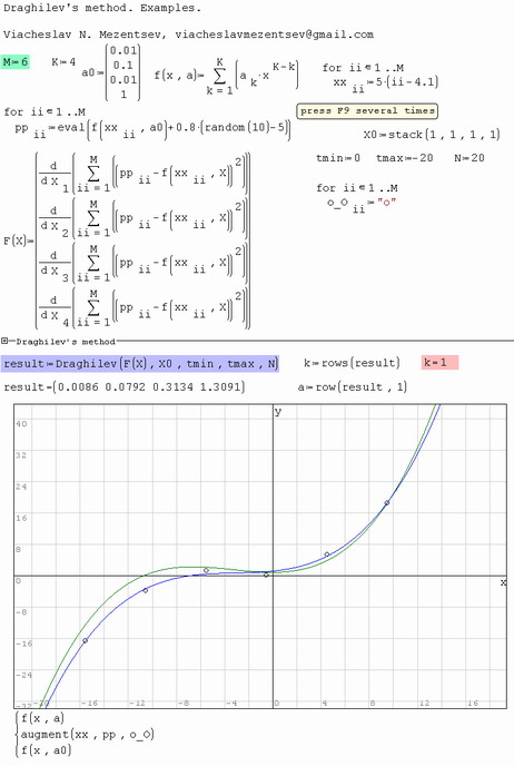

#12 Опубликовано: 04.10.2012 21:54:18
Radovan, I can't say something in your case. Yes, there is a problem with the Jacobian. I can't understand what exactly is the problem, so we turn to a simple example for now.
Draghilev's method. Finding roots. System 2 version 0.2.smz (7,06 КиБ) скачан 1411 раз(а).
Radovan Omorjan 05.10.2012 02:28:00
#13 Опубликовано: 05.10.2012 00:51:53
I have something fixed in the plugin. Download the new version and try to calculate this example. Everything is the same, but now it sometimes works even with five points. Then the problems begin with the maple().

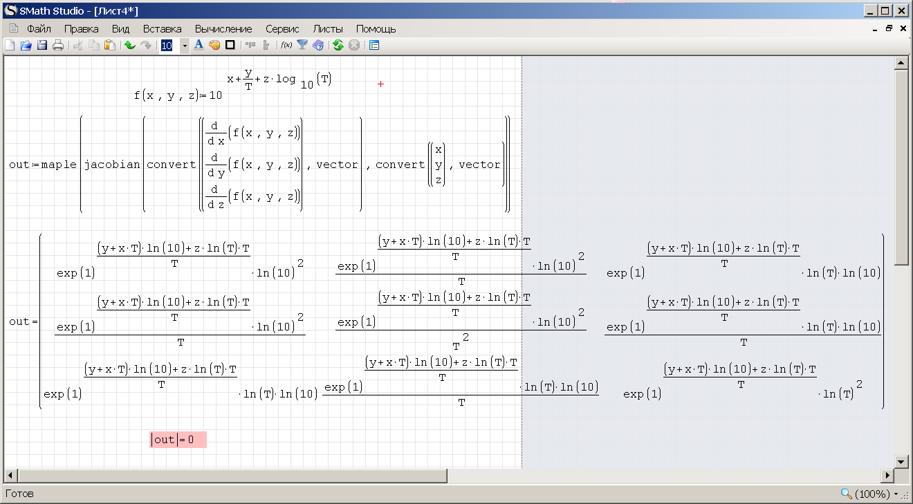

By the way, I bumped many times into the derivative, gradient, Jacobian problem in SMath and almost always had to give it up. I even asked Andrey few times to introduce numerical differentiation in spite of the well known fact that numerical differentiation is prone to numerical errors. Calculating even derivatives (Jacobian is another nightmare) analytically is sometimes almost impossible and there is no other way than using some kind of numerical approximation. Therefore, when Jacobian is involved in some calculation - I always find myself unconfortable
EDIT: You are right - Pressing F9 several times can make it work. The error message was always "Action could not be performed with text" .
By the way, I even get the results of this function
[MATH=eng]f(x,a):sum((el(a,k)*x^{K-k}),k,1,K)+sin(x)[/MATH]
but after pressing F9 quite a lot of times.
#15 Опубликовано: 05.10.2012 08:10:05
Unfortunately, the plugin can't correctly translate all that much data with which it communicates with the Maple. Do not forget to delete the file mvr5.txt. Here you can see the language in which the plugin communicates with the Maple. And one more example. I increased the dimension of the problem and the number of points.
Radovan Omorjan 05.10.2012 08:27:00
