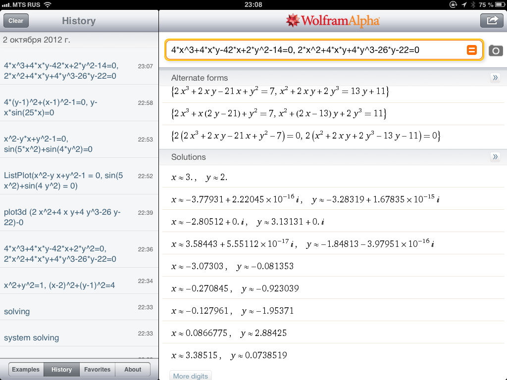

It seems that now there is all I needed to demonstrate the method. I will try to show step by step how to use the solver. As for the theory, Alexey will help me.
Example 1. Finding extremes: Himmelblau's function:
[MATH]f(x;y) : (x^2+y-11)^2+(x+y^2-7)^2[/MATH]
[MATH]sys(4*x^3+4*x*y-42*x+2*y^2-14=0;2*x^2+4*x*y+4*y^3-26*y-22=0;2;1)[/MATH]
P. S. Buchberger's algorithm can solve systems like that much easer.

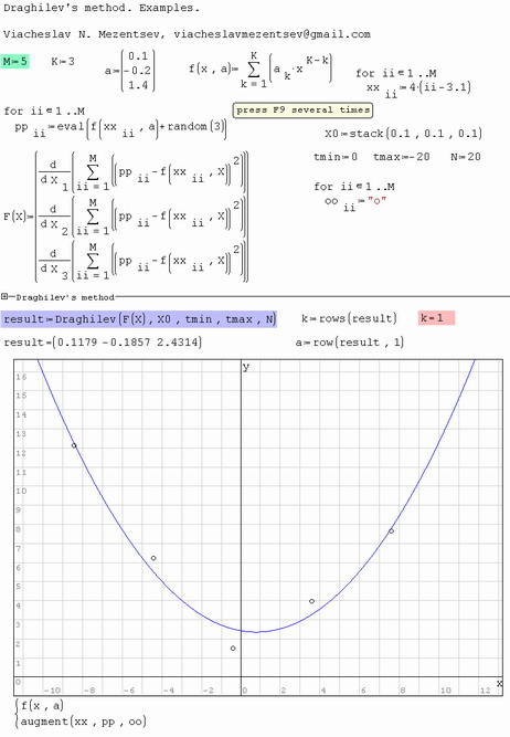

#9 Posted: 10/4/2012 6:47:37 AM
#10 Posted: 10/4/2012 7:36:12 AM
But it is possible.
P.S. This is not a correct example too, the determinant is zero. The sum of squares must be on all points.
Draghilev's method. Approximation. Simple example.smz (5.77 KiB) downloaded 1430 time(s).

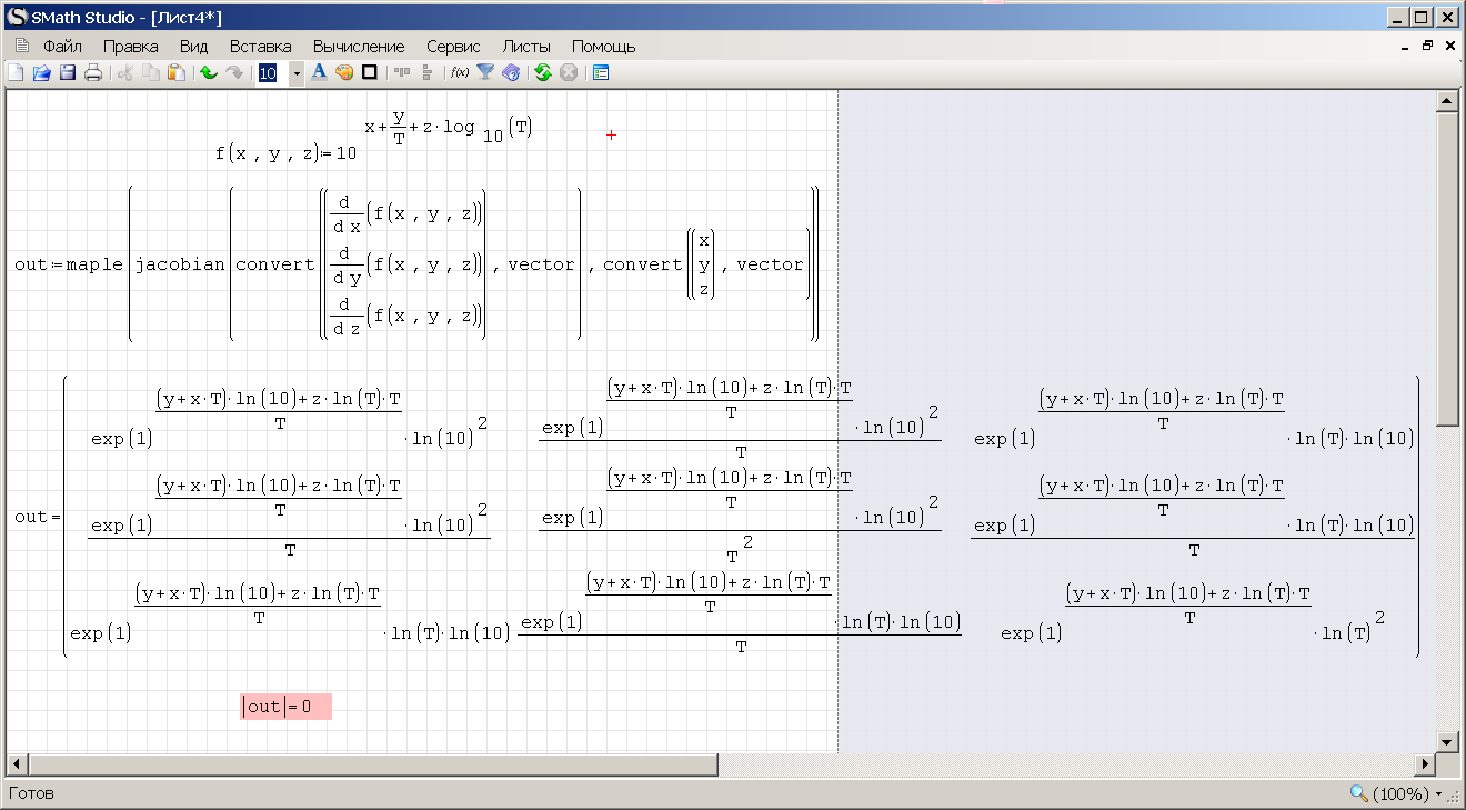

Radovan, I can't say something in your case. Yes, there is a problem with the Jacobian. I can't understand what exactly is the problem, so we turn to a simple example for now.
Draghilev's method. Finding roots. System 2 version 0.2.smz (7.06 KiB) downloaded 1411 time(s).

Thank you uni for your time,
I also tried your simple example yesterday and was surprised that it worked well, but for some data worked well and for some other did not - as you mentioned.
I will try this new example as soon as your server become available (temporarily down at the moment)
By the way, I bumped many times into the derivative, gradient, Jacobian problem in SMath and almost always had to give it up. I even asked Andrey few times to introduce numerical differentiation in spite of the well known fact that numerical differentiation is prone to numerical errors. Calculating even derivatives (Jacobian is another nightmare) analytically is sometimes almost impossible and there is no other way than using some kind of numerical approximation. Therefore, when Jacobian is involved in some calculation - I always find myself unconfortable
EDIT: You are right - Pressing F9 several times can make it work. The error message was always "Action could not be performed with text" .
By the way, I even get the results of this function
[MATH=eng]f(x,a):sum((el(a,k)*x^{K-k}),k,1,K)+sin(x)[/MATH]
but after pressing F9 quite a lot of times.

Unfortunately, the plugin can't correctly translate all that much data with which it communicates with the Maple. Do not forget to delete the file mvr5.txt. Here you can see the language in which the plugin communicates with the Maple. And one more example. I increased the dimension of the problem and the number of points.

Thank you uni,
Still pressing F9 lots of time is needed.
Wish you good luck in resolving this problem and improving the plugin

Press F9 need to generate random numbers. I think that this should be on the expression where it is described (inside it). I get the result after every of 5-7 pushing. You can also increase the spread of the points (instead of a factor of 0.8 to take a little more).
Hmm. As I see it, in SMath used arc*() style, isn't it? (Russian interface) If Europe is different, I need to give a complete list of mathematical functions, where you need to make corrections, and three letters of the interface language (or just language name).

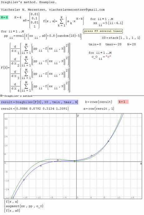

P.S. Radovan, I think that you need something like this: Nonlinear Regression II, Fitting a Curve to a Data Set with the New Gradient Operator

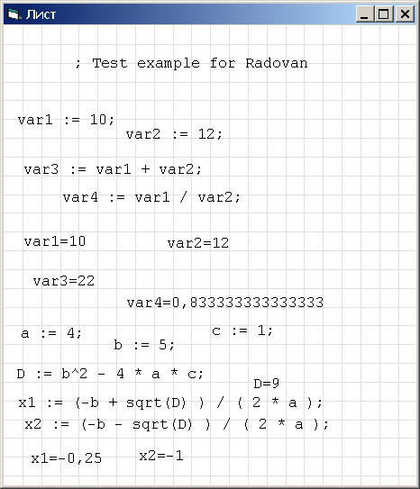

Radovan, if you want to understand it better, then you need to try to write the interpreter symbolic computation by yourself. It's not that hard. There is even an introductory book - Computer Algebra with SymbolicC++.
P.S. On the picture is a simple example of the SMath-style calculator, which is written in VB6: sources (draft, russian).
#20 Posted: 10/5/2012 12:35:51 PM
Sorry, uni - I did not make myself clear enough
I did not mean by "understanding" to know how SMath is working in programming sense in order to make plugins, or things like that. I am to old for that and it is beyond my capabilities. I was just thinking to understand it from the SMath user point of view - in order to use it like a math and engineering tool. I want to use it in order to solve my standard problems that I have in my class, and to understand pretty well how to solve those problems by using SMath. Unfortunately, I am to often getting confused by struggling with its own problems - like symbolic engine, its optimization feature etc. I do not often understand SMath behavior, can not often rely on its results etc. Maybe a much better explanation of our frustrations at the moment gave Martin Kraska (mkraska) in its recent post Post by mkrska.
Quite similar frustrations had and still have Mathcad "oldtimers", but it can not be compared with SMath.
